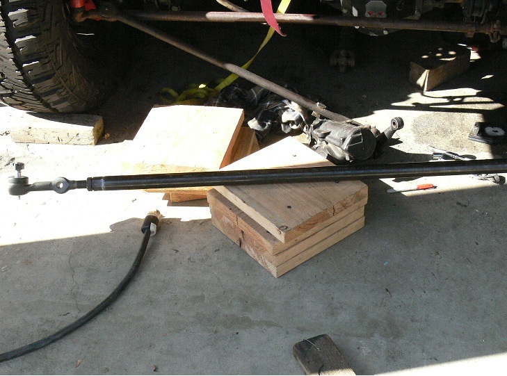

Made up the new tie rod yesterday now I just have to ream the mounting holes to fit the chevy 1 ton TREs.

For the last two days I have been hitting it pretty good as I have to have the truck out of the garage by this coming Friday. Things done are steering gear box mounted, Steering column shaft & knuckles, Hi-press steering line is welded up(two lines made in to one) Got me reamer so I can do the 1 Ton TRE cross over now. Things left to do are front brake lines, double check pinion angles before final welding, make new track bar mount on D44, and lastly install front shocks.

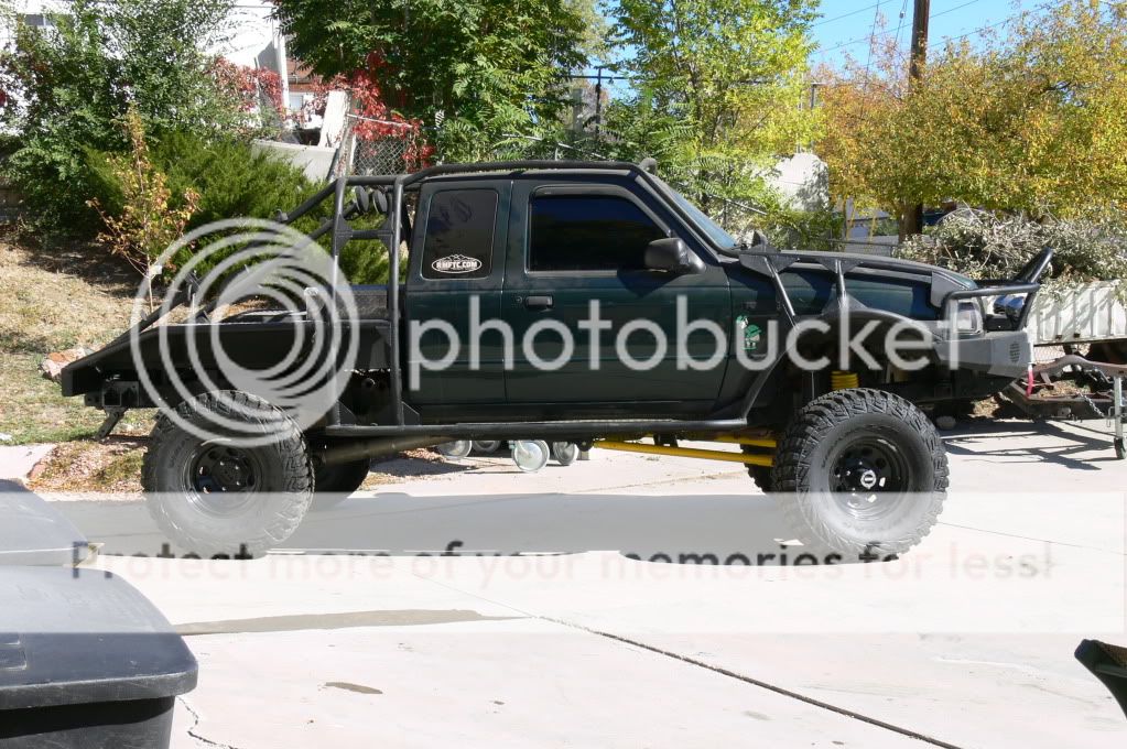

Well on Saturday morning it was driven out of the garage for the first time since starting the swap, still need to do the front shocks. Also am having a problem with the 9", the drivers side is locking up like it is the brakes but cannot find anything wrong with them, so not sure what it could be causing it.
Nice!! def time for a wash on her lol

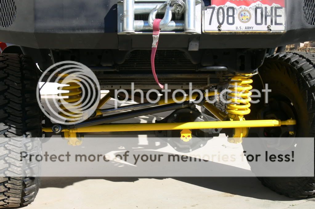

truck looks great brother. You don't have any issues with your tierod hitting the Ballistic cover? I couldnt install mine on D because i hit the cover about a 1/4 turn before lock i hit it with the Tirod.
Josh it does hit the cover at close to the same point. For now I just adjusted the stops out enough to stop it from hitting until I take the cover off to put in a locker. Then I am going to cut out the portion the hit and reverse it and weld it back in or get the high steer knuckles and go that route.
