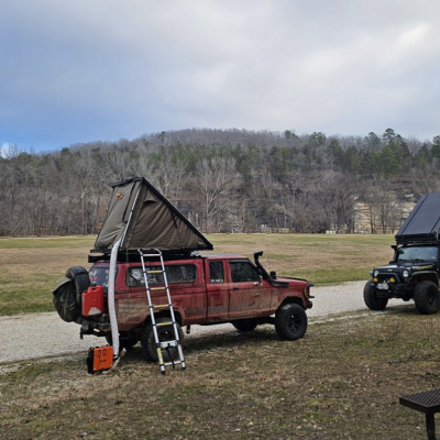

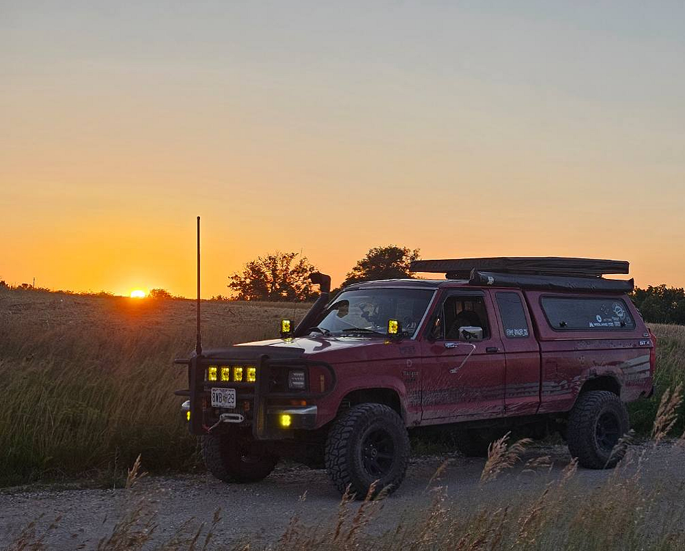

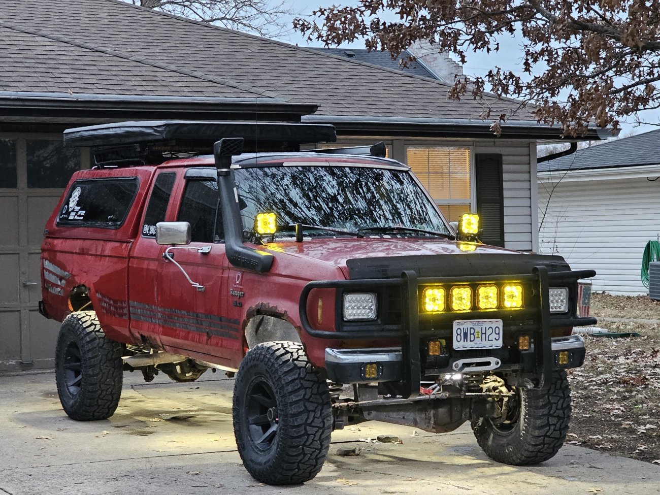

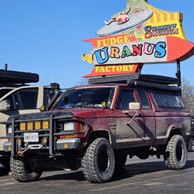

The good news is you don’t. The 1988 Ford Ranger STX 4×4 you see here is owned by forum member ‘mc_raptor_820’. The truck has been named ‘Clifford’ and I have to wonder if it comes from ‘Clifford the Big Red Dog’. Clifford didn’t receive a bunch of extensive mods, just the needed ones.

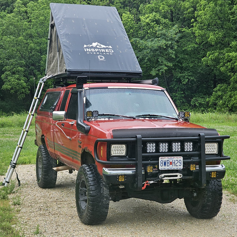

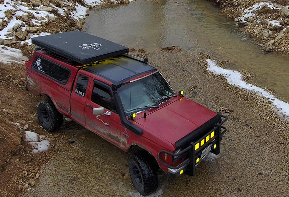

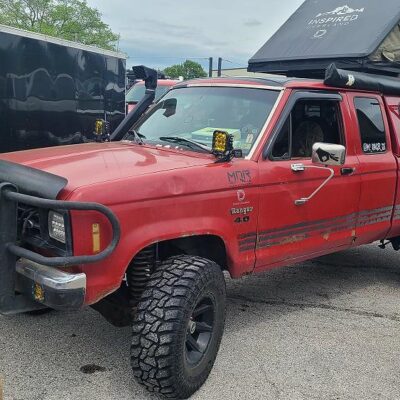

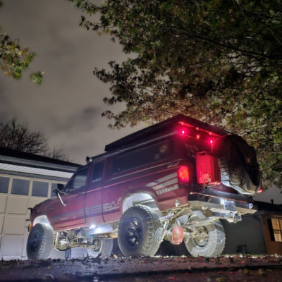

The 7.5-inch rear axle was replaced with a Ford 8.8-inch out of a 1999 Ford Explorer that came with larger 31-spline axle shafts and 4.10 gears. The Dana 28 TTB front axle was replaced with a Dana 35 TTB and regeared with 4.10 gears to match the rear. A Rough Country 4-inch suspension lift makes room for Celimo 32×11.50r15 M/T tires. The rear actually uses 4-inch lift leaf springs, not blocks.

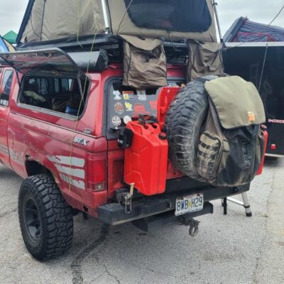

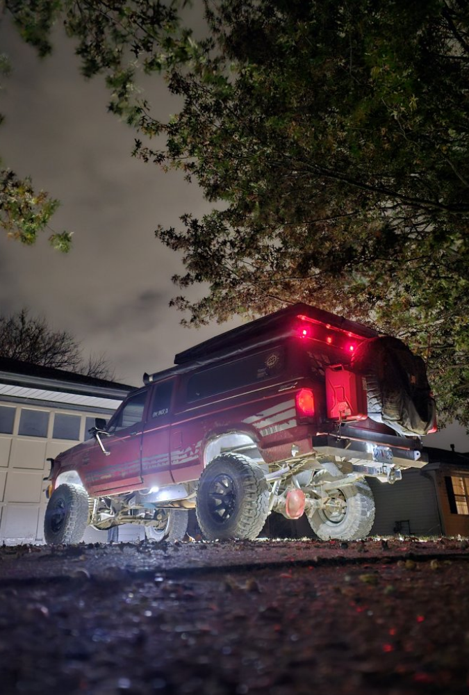

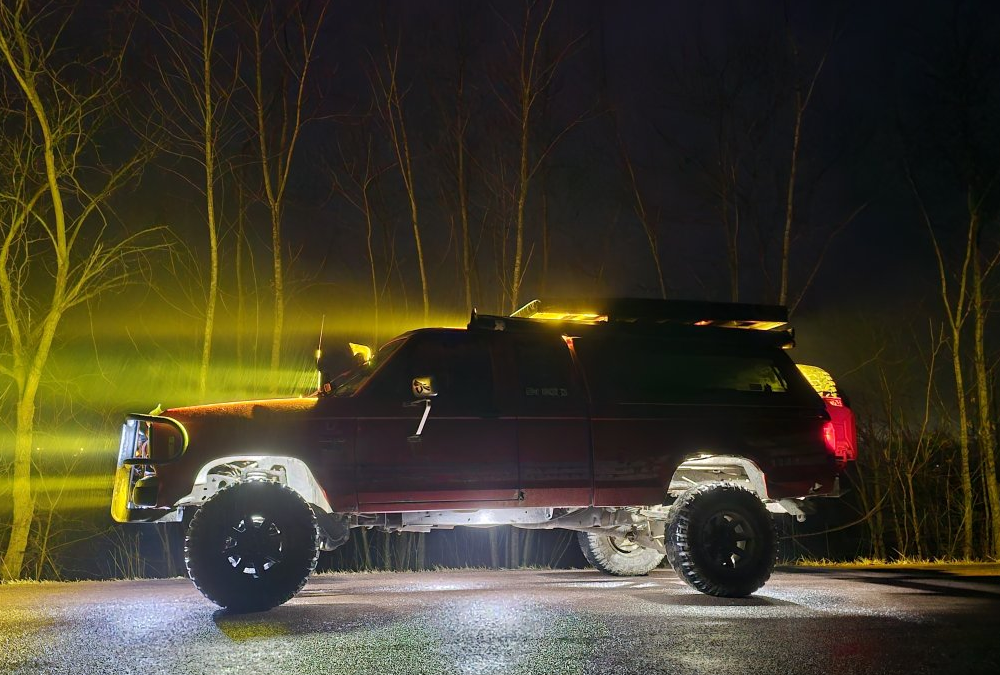

A 270-amp alternator keeps two yellow top batteries charged under the hood. Two 100-watt Renogy solar panels on the roof charge a Renogy 100ah AGM battery mounted in the bed. The battery enables a 45L fridge/ freezer to run 24-hours a day. All of the exterior off-road lights and rock lights are from Diode Dynamics.
Clifford The 1988 Ford Ranger STX Overlander - Left Rear

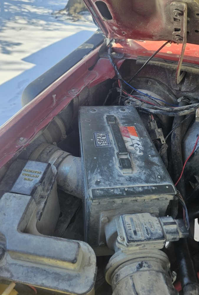

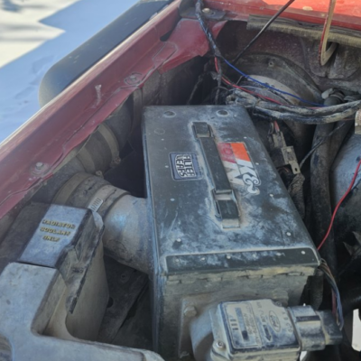

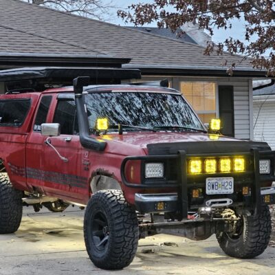

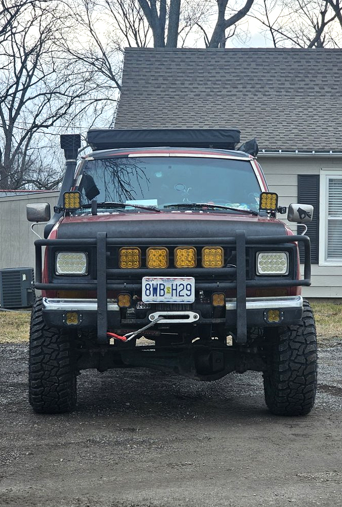

The snorkel is from a 1989 Toyota Land Cruiser. He used a factory 4.0 intake tube with the factory air flow sensor mounted to an ammo can with a section of 3-inch pipe off to the side to connect the intake to the snorkel.

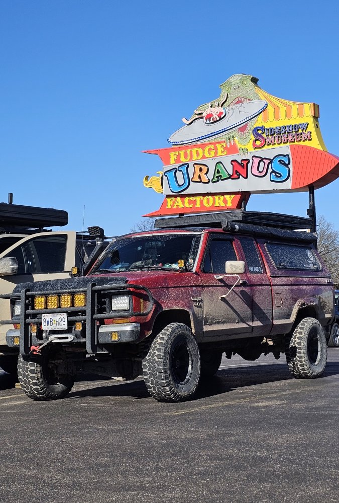

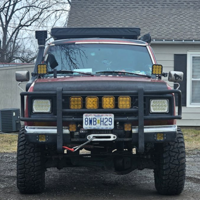

The grill guard was found for $100 and modified to fit the Ranger.

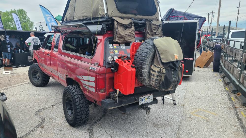

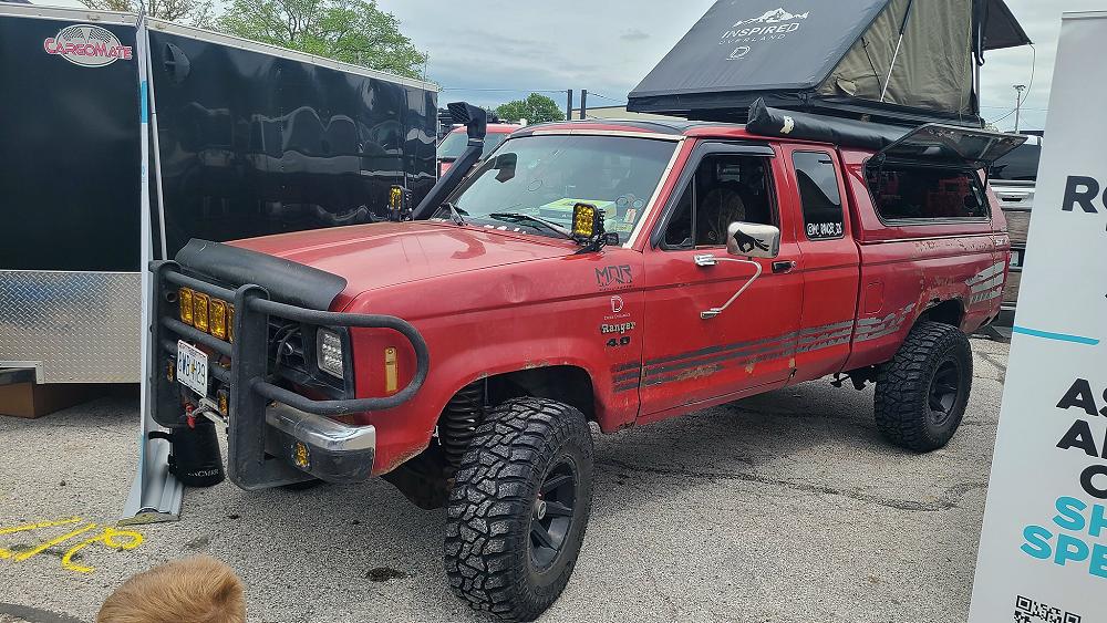

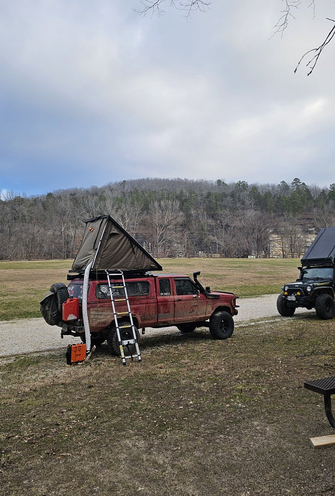

The roof top tent is a standard size tent from Inspired Overland and a Vevor diesel heater keeps the tent warm in colder climates. Don’t get intimidated by the cost of a roof top tent. People think they have to have one, spend over $1000 to buy one, use it once, and eventually list them on Facebook Marketplace for $600-$800.
Don’t think that you need a new truck or an expensive setup to go out and have your own adventures. Clifford proves that you don’t.

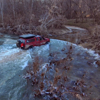

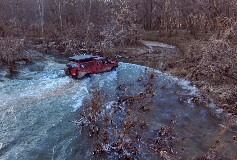

Clifford The 1988 Ford Ranger STX Overlander River Crossing
