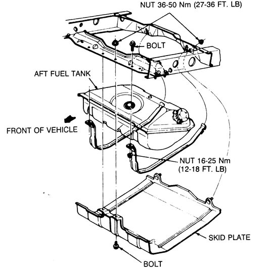

  6. Support the fuel tank assembly. Remove the strap attaching nut at each tank mounting strap.
  7. Swing the strap down and lower the tank enough to gain access to the tank vent hose.
  8. Disconnect the fuel tank vent hose at the top of the tank. Disconnect the fuel tank-to-separator tank lines at the fuel tank.
  9. Lower the fuel tank and remove it from under the vehicle

Ford Bronco II Fuel Tank mounting diagram
Ford Bronco II Fuel Tank Diagram
