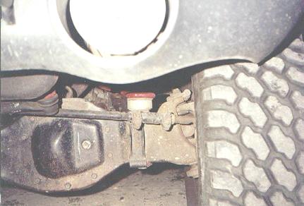

1983-1997 vehicles - These vehicles with the Twin-Beam suspension can be lifted using a spacer under the front coilsprings. These spacers range in thickness to provide about 1 - 2" of lift, and fit over the axle stud/bolt that secures the lower spring perch. You can also use large diameter washers as shims to raise it as well. You can stack as many spacers/washers as needed as long as there is sufficient thread length to reattach the spring retainer & washer.
On 2WD vehicles, you can replace the bolt that runs through the axle-beam with a longer one. The stock bolt will only allow you to add about 3/4" spacer. Be sure to use a grade 8 bolt & nuts.
There are also new coils you can purchase called "leveling" coils that will usually provide a 2" lift or so. These will vary in the actual amount of lift depending on body type and engine, though. A V6 Supercab will get less lift from new coils than a shortbox 4cyl. They also are more costly than simple spacers, but could add a bit more flex.
4.0L Supercab or Explorer coils can be used on a lighter shortbox Ranger for a little lift, also. This will stiffen the ride considerably (might be good if you play real rough).
Keep in mind however, once you exceed about 2" of lift (2.5" on 2WD), you stand a chance of not being able to realign the front-end back to proper specifications. This will vary from vehicle to vehicle. Some vehicles may still be alignable at 2.5" (3" on 2WD), however.  This will depend on where the setting is currently at on the vehicle you wish to lift.  In general, I have found Supercab 4.0L V6 Rangers to have more adjustment range left to allow for more lift than 4cyl or shortbox models.
Pictured is a coilspacer on a Twin-Beam 4X4. The 2WD setup is similar. (notice one washer under it. Washers can be combined with the spacer, if needed)
These spacers can be had at most 4x4 shops for around $30-40 for the pair. The Ford dealer also sells a similar item that was intended for use on 2WD F-150s. these can be adapted to function the same as the above pictured spacer.

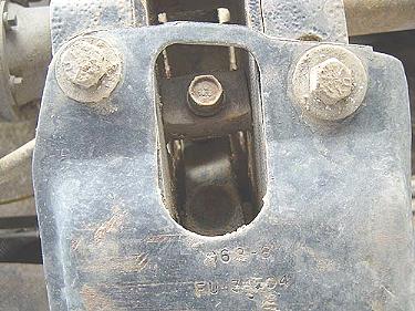

1998 + Vehicles - For those of you with '98 to current 4x4 and Edge/Trailhead models ('95-'01 Explorers), you're in luck as far as cost goes. These are the easiest and cheapest (free!!) to get that little bit of lift out of.
These vehicles use a torsion bar suspension and the amount of "preload" on the bar is adjustable at the rear end of the bar. All that's needed is a couple turns with a wrench and wala! You just gained an inch. Don't overdo it, though. On these models its not good to crank them for more than 1.5-2" lift, otherwise you will lose most of the suspension's down travel which will make for a rather rough and jarring ride. Over cranking it can also cause the torsion bar (spring) to sag.
It is recommended you jack the truck up so the weight is not on the suspension while you adjust them. Be sure to adjust both sides equally or you will end up with a leaning Ranger.
A front-end realignment afterward is not required on these models, but is still recommended.
Shown is the torsion bar adjuster.

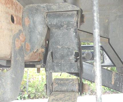

One is Lifting Shackles. These longer shackles replace the existing leafspring shackle at the rear of the spring and provide about 1" of lift for each 2" over the length of the stock shackle. These run about $40 or so. Some shackles are sold as lowering shackles for Chevrolet fullsize trucks. Because the shackle mount is inverted on a Ranger from what the Chevy is, it will lift the Ranger.
Heres an extended shackle on a Ranger. This particular unit was homemade out of a stock shackle (the ultimate in "cheap"!). A reinforcement was welded to it for lateral stability.

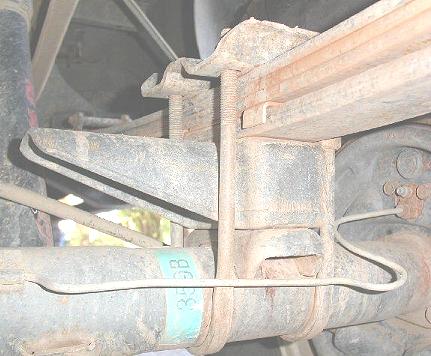

Another option is to put an Add-a-Leaf in the leafspring. This is simply another leaf you add to the stock spring to boost it up a little. The Add-a-Leaf (unlike the shackle) will stiffen up the ride significantly, however it will make for less sag when you throw a heavy load in the back.
If you own a 2WD Ranger, you also have the option of picking up a pair of factory 2" 4x4 blocks from a Ranger in a junkyard. These will fit a 2WD perfect as there are no differences in the stock suspension other than 4x4s have a block and 2WDs do not. Be sure to also get the axle U-bolts with the blocks. Longer shocks may also be needed. Use shocks for the 4WD application.
(4x4 block)
Lastly, leafsprings from a Ford Explorer will fit the Ranger. The Explorer spring will provide about a 2" lift on a Ranger. They are stiffer and will ride similar to using an add-a-leaf. The center pin on the leafpack will need to be turned around, as the Explorer uses a spring-under-axle configuration. Because these pins are usually frozen solid with rust, replacing it with a new one will be best.
