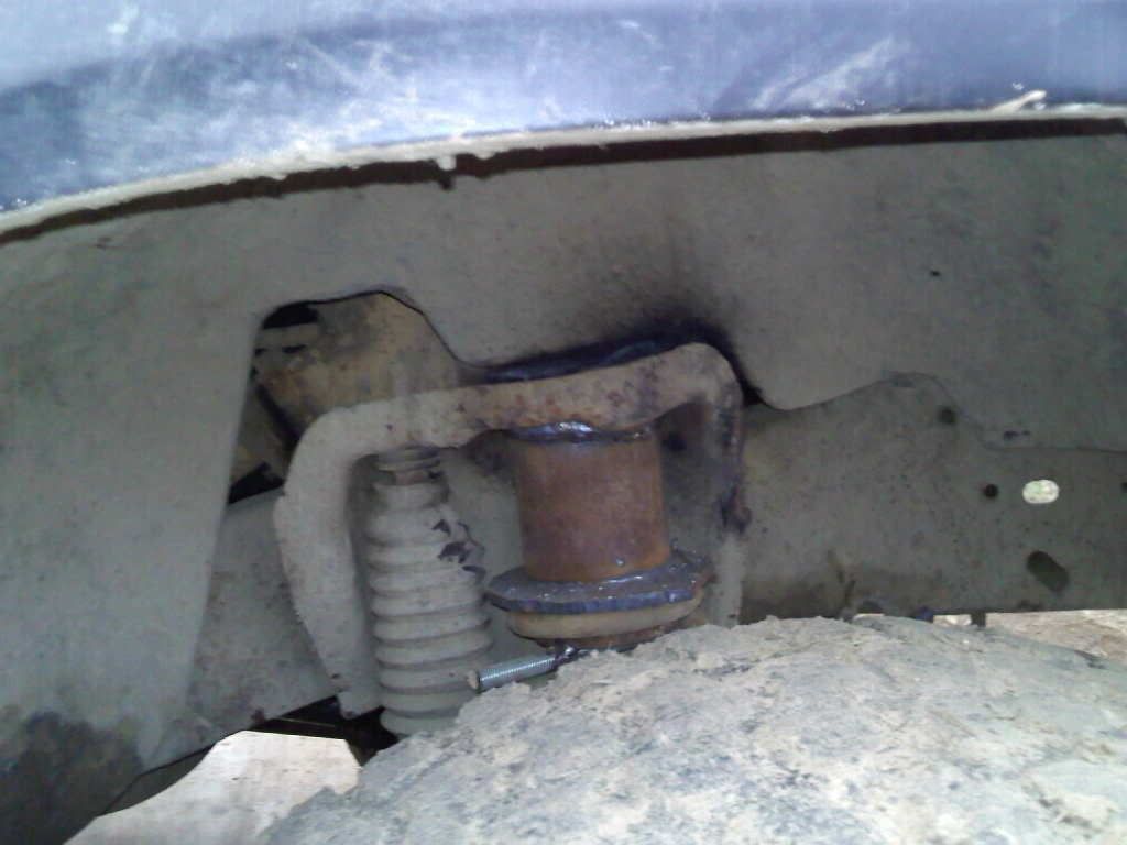

Spent about 6 hours putting the Brackets in my Rig today and they fit well but if I build another set for my daily driver will have to make the radius of the top/front bolt mount on the passenger side frame rail bracket slightly larger(just incase any one is planning on making some keep that in mind, If you look close enough you'll see I had to burn the hole bigger on the crossmember ) , tomorrow I will be extending the radius arms and making a crossmember to hold them as well as some modification to the coils and buckets hillbilly style. That should be enough to get it rollin again.

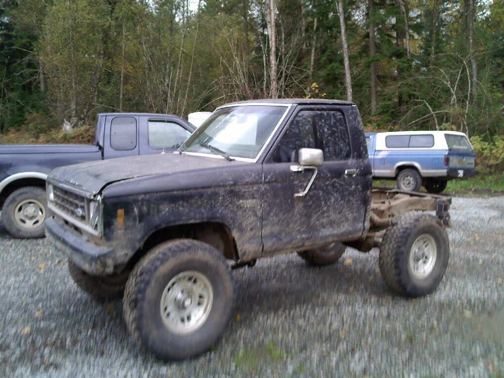

Another days work and my rig is rollin again, just a few things left to tweak and I can do the back end. I decided not to replace the transmission crossmember and just weld on some bushing style joints

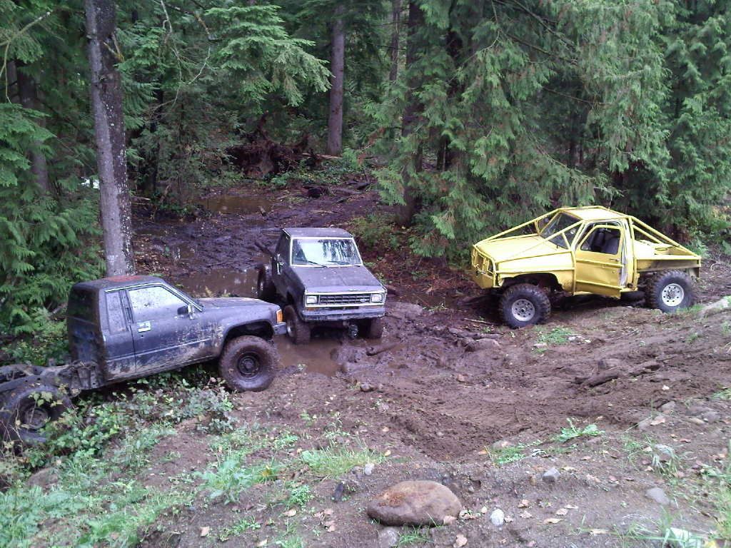

Lengthened drive shaft and installed, a few more pictures and comparison to my Daily driver. How about those spacers....LMAO!

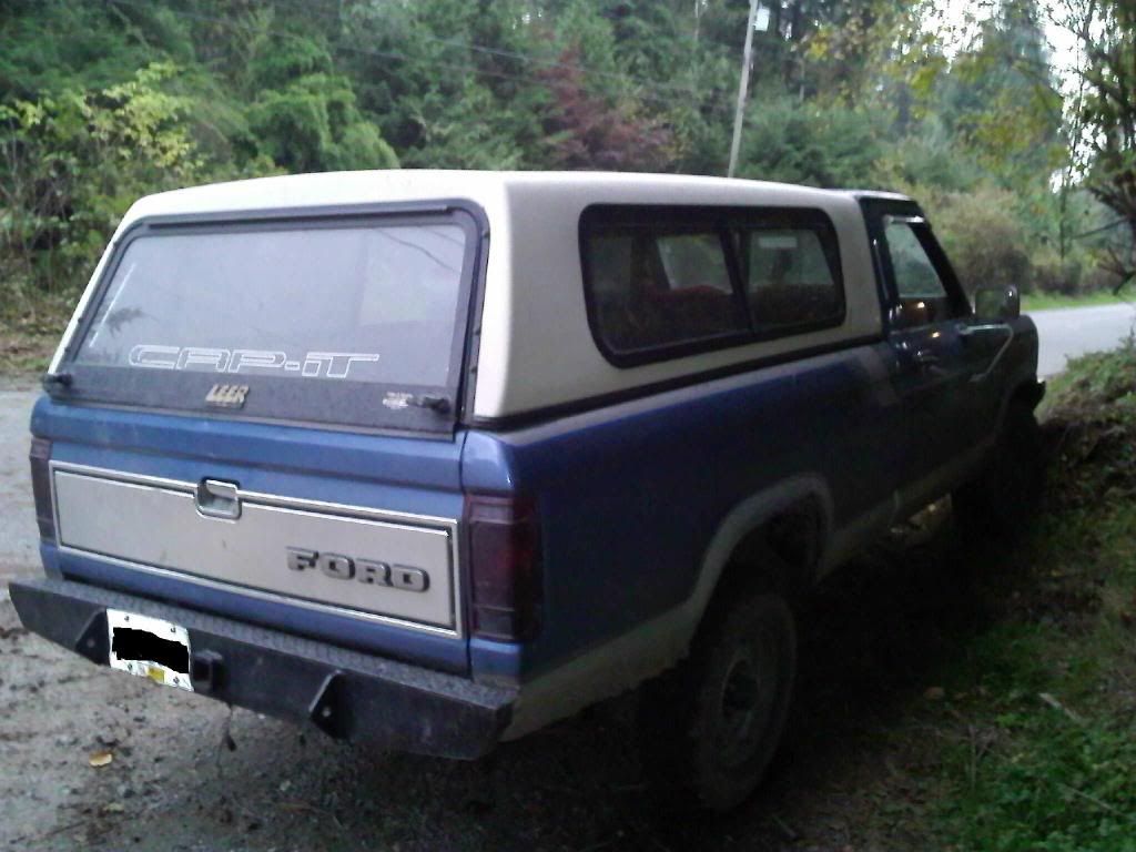

And my back bumper...
Rear end is shortened now and it looks WAY BETTER! Even Had a chance to test it out. I think thats pretty much it for the suspension. just need to hook the shocks up and ill start the fun stuff, gonna look similar to the yellow truck when its finished. Wheel base is somewhere around 102"
