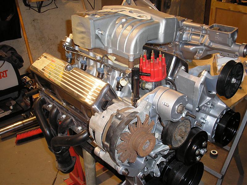

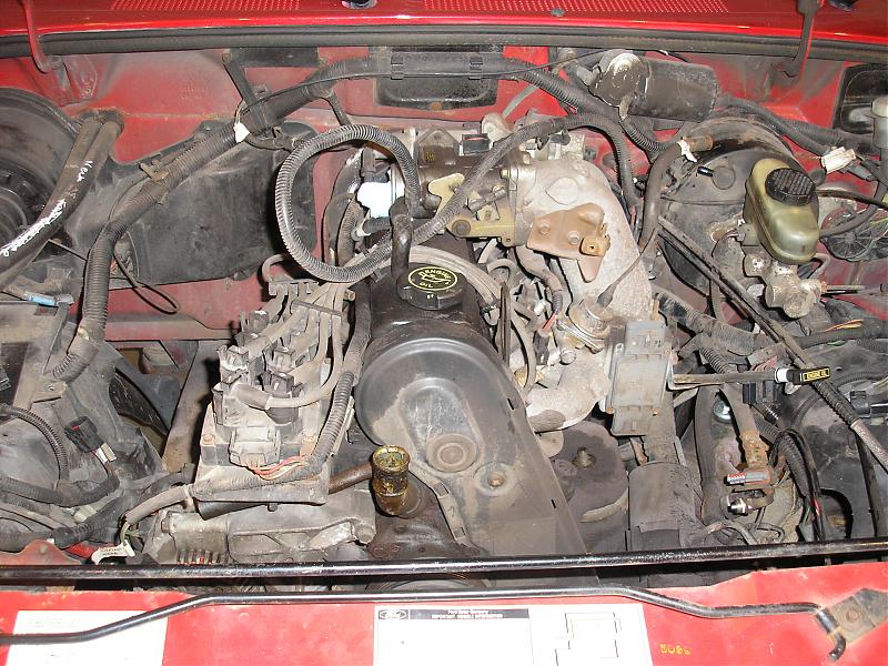

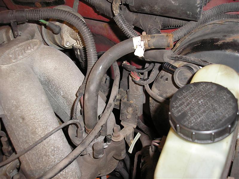

Well, the truck is in the garage, all fluids bled, and a butt load of connectors, um, disconnected.

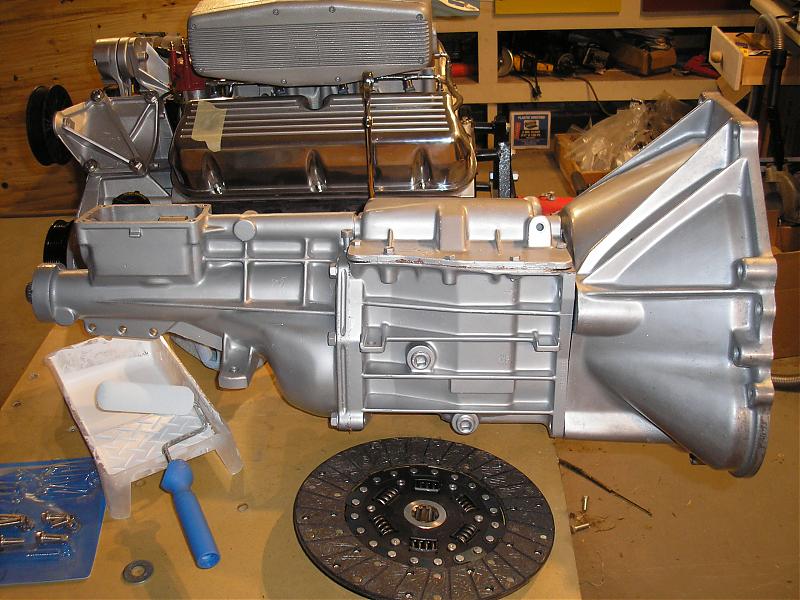

And here's whats going into the truck, oh she is a BEAUTY!!!!

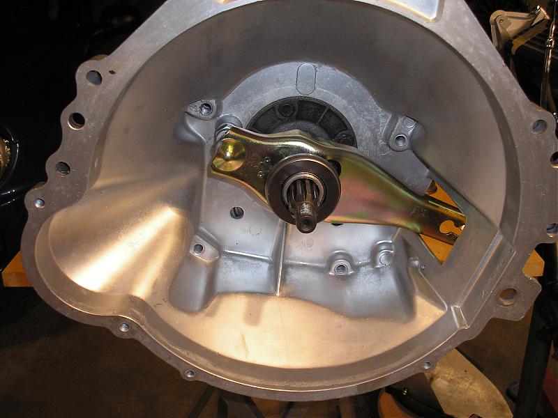

Ford 302 no smog, no a/c, and no lack of power, sweet! The tranny is a NWC Borg Warner T-5 from a Mustang GT, fully rebuilt and ready to go.

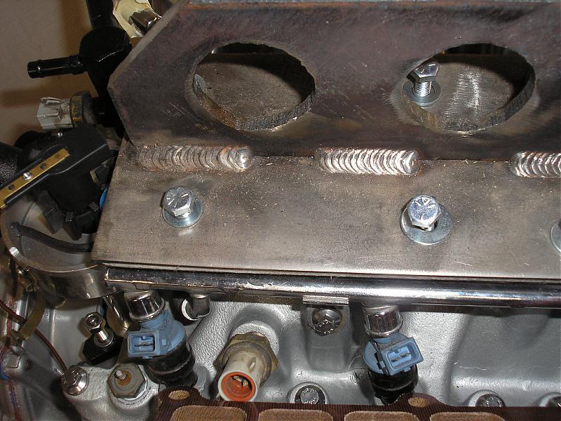

And this is my custom made engine lifting mount, 5/16" steel lifting plate and 1/4" stainless steel lifting base. All cut and welded by yours truly

What kind of intake is that?

It's pretty much a copy of the Edelbrock performer intake from a Mustang. Better clearance, more power, and not speed density like the intake from the f-150.

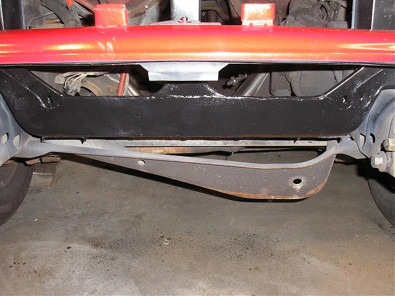

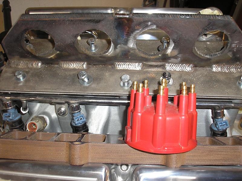

Well, the motor and tranny are removed, the motor brace cleaned up and ready for some VERY EXPENSIVE POR-15.
I don't know if any of you guys had to do this, but I had to do some custom fab work on my inner support. The bottom front was almost rotted completely out.
Can't even tell, can ya?!
A body lift and some 1/8 steel plate for frame-boxing is on the way........
Attachment 1036 Attachment 1037 Attachment 1038
Attachment 1039 Attachment 1040
And this is my custom made engine lifting mount, 5/16" steel lifting plate and 1/4" stainless steel lifting base. All cut and welded by yours truly[/QUOTE]
you are going to use the tranny Borg w t-5 with transfer ???
