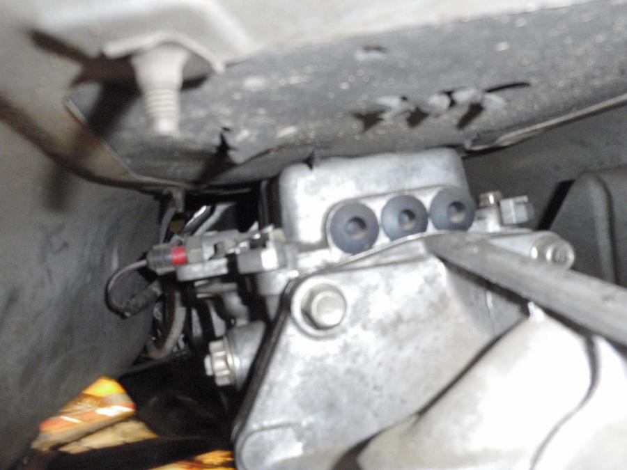

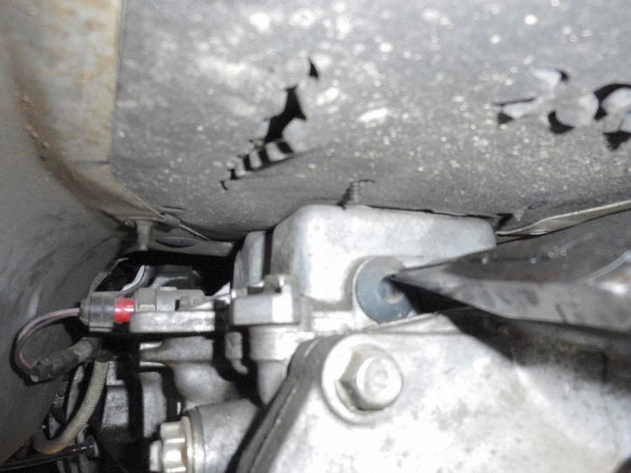

Attached are some pics from my last shift rail plug replacement, easily done from underneath.
Charles

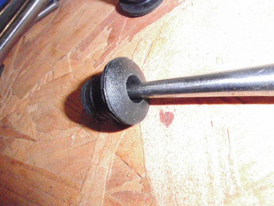

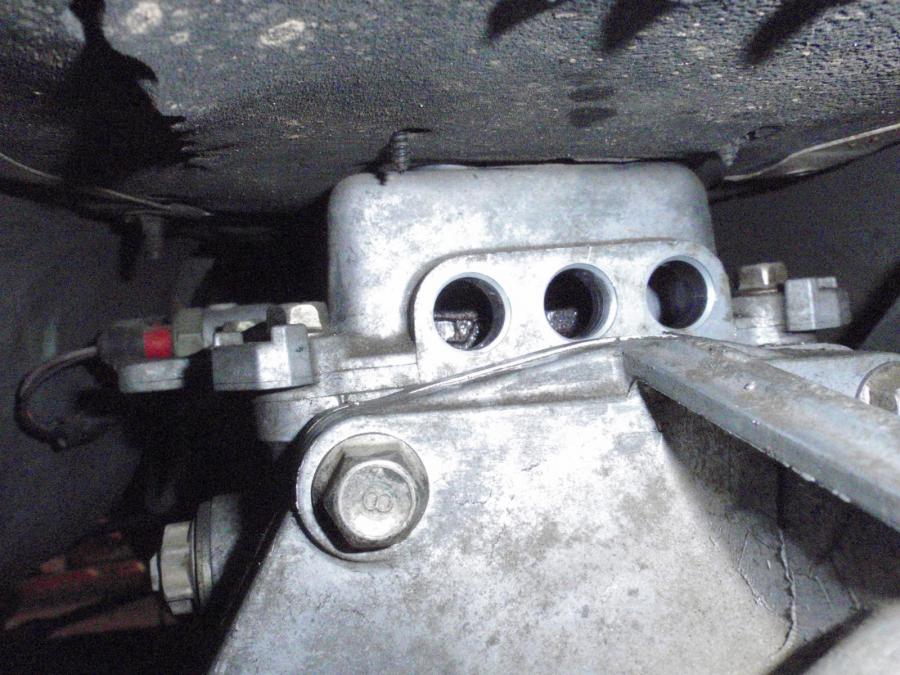

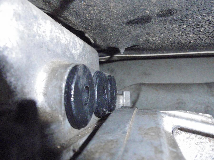

A few more pics from the underside. Use a straight flat ended punch that just fits in the hole in the plug to install them. When you push on the punch, it tends to stretch the plug, making it thinner and it slides in easily. When you release pressure on the punch, the plug reforms to size and is a tight fit, makes it very easy. Clean out the holes in the trans with something to degrease the hole and leave it very clean and dry, such as naptha on a clean shop towel and use your pinkie to push the rag in the hole. Put the plug in dry, it will stick tight to the hole and not move or creep or leak.
Charles
  • 26 Mazda transmission shift rail plugs close up of new plugs to verify installation.jpg
