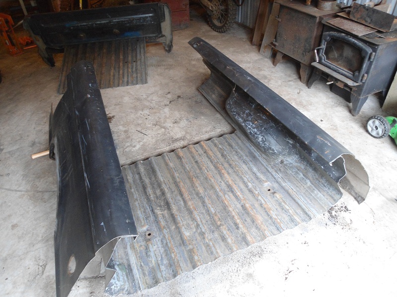

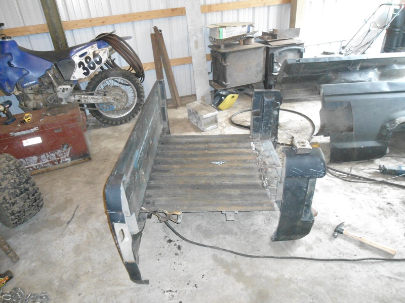

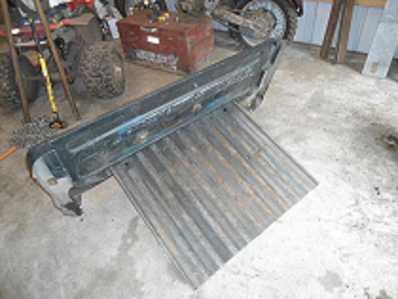

alright got some work done on it today, got the front and floor cut out and it is only 3 feet from the front of the bed to the tail gate
dove tail the bed
what was left of the bed after the floor front and rear was cut off

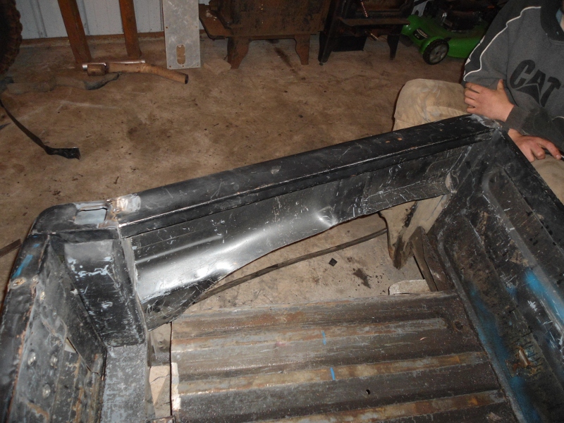

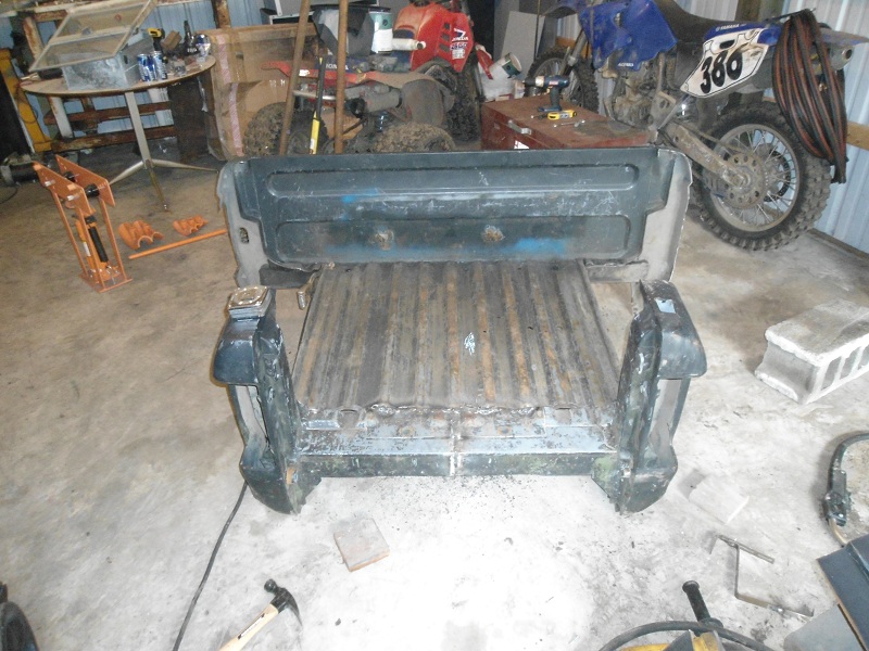

got the rear narrowed 20 inches total
dove tail the bed

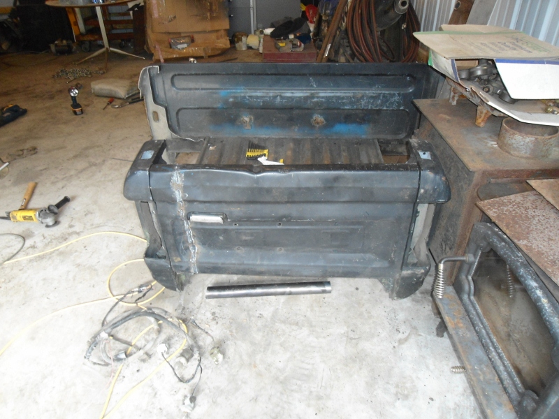

looking at the bed from the rear with the back welded on to the floor
dove tail the bed
looking from the side you can really tell how short it is going to be

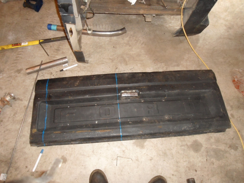

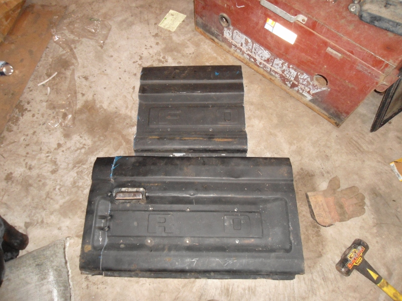

got the tail gate measured out and marked to narrow it
dove tail the bed
the tail gate tacked up and with the section removed about it
dove tail the bed
the tail gate on the bed before welding it up
dove tail the bed
tail gate welded and with the tail lights in

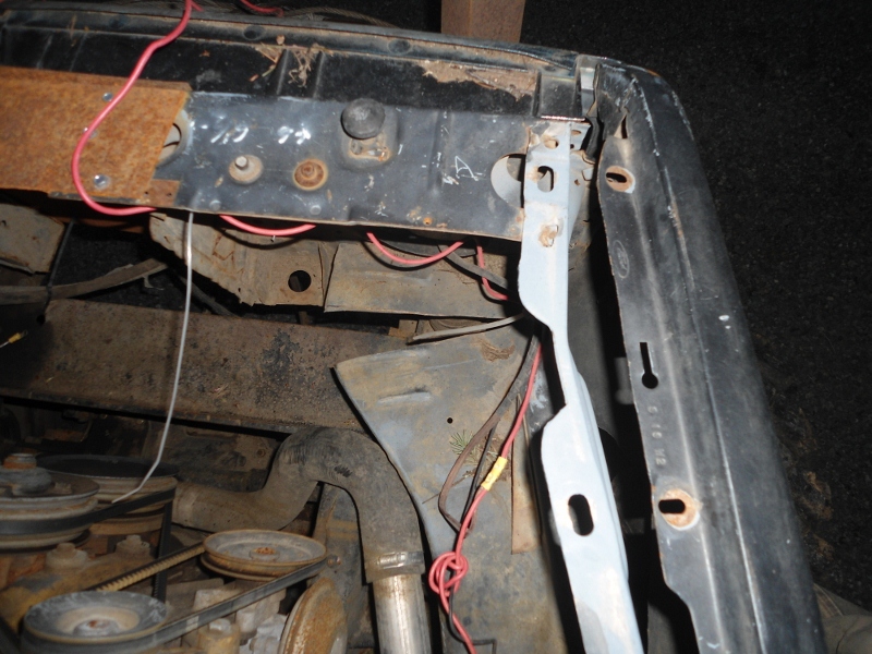

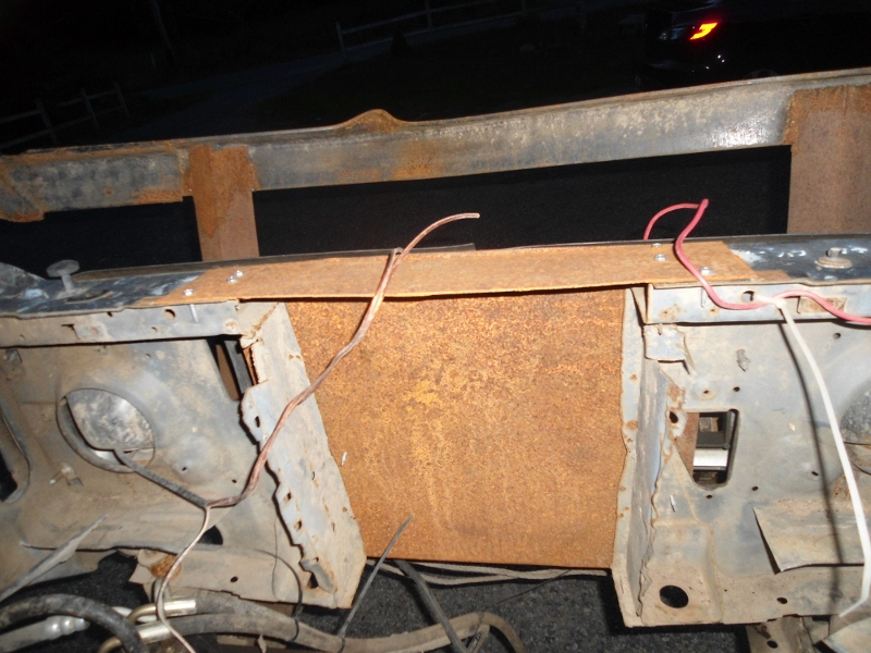

smurff here are a few pictures of the front end, remember i am not running the radiator up front and it is never drove on the road so the fenders are only bolted on in the very front by the head lamp by those 2 bolts, the rear bolt in the engine bay, bolt behind the door, and the very bottom bolt by the door
dove tail the bed

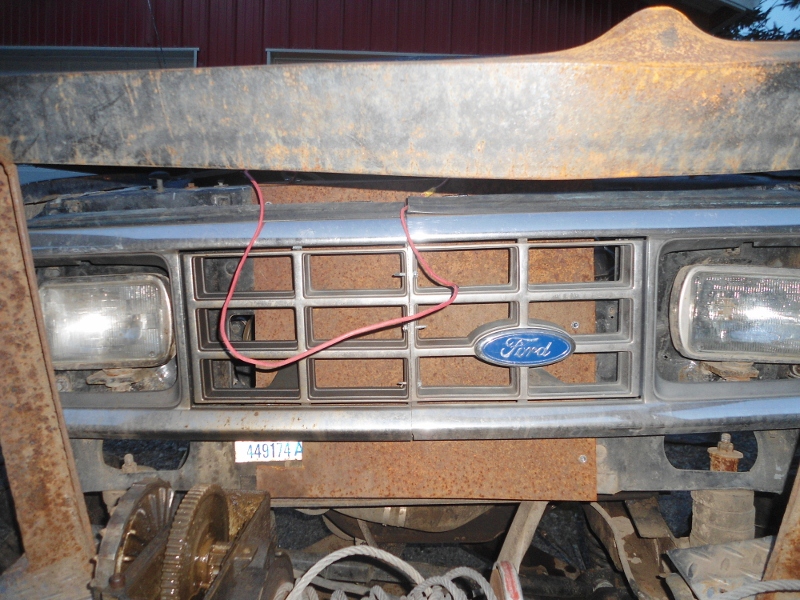

just cut out 3 sections out of the grill and self tapped it together
dove tail the bed
as you can see the fender does not sit like it did from the factory but if you notice in the pic at the bottom of the inner fender i cut it back and you cant see in this pic but when you look at the inner fender it is wavy for ridgibility and i cut the bump on the engine side so it would bend and not cause any big issues
dove tail the bed

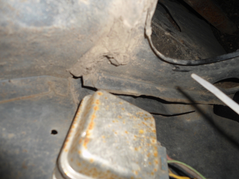

you can see a cut just below the voltage reguator and this is at the firewall same thing as the front but cut on the fender side and at the very top the gusset i just cut a v into it
dove tail the bed
as you can see i just put some sheet metal over the gap and bolted it to the core support, i just cut the core support were the hole is for the radiator out of it and narrowed and replaced it with sheet metal

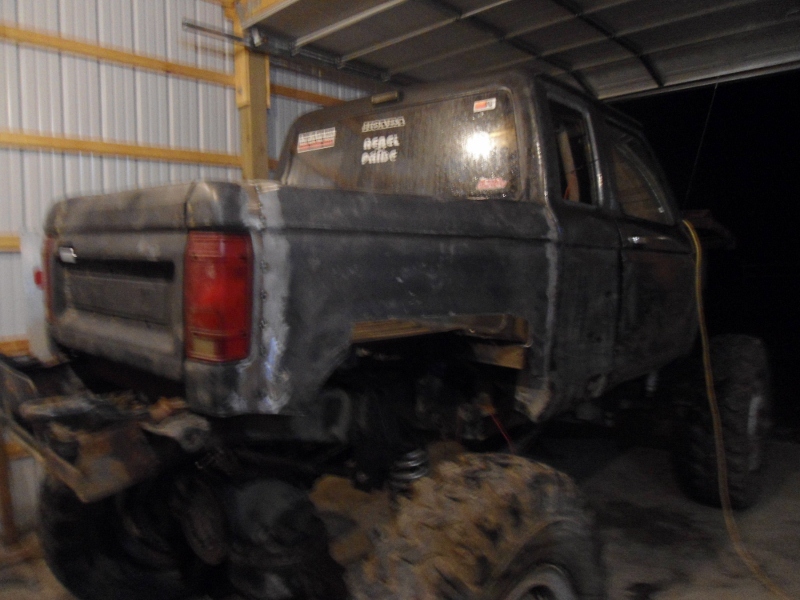

my brother and i got the sides put on the bed the other night, the wheel well has not been cut yet
dove tail the bed
decided to cut the wheel well hump out of the bed made it alot easier to mount the sides and figured i could use the extra room
dove tail the bed
set the bed on with the tail gate and tail lights in it just to see how it looks, i like the narrow look at the back dont have to worry about a exo cause there really wont be any damage to the body besides the cab but o well on that it is still factory strong.
dove tail the bed
here is a side shot of the bed on the truck will try to get the sides cut and inside finshed and get you guys some finished pics here in the next week or 2
