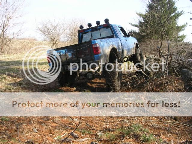

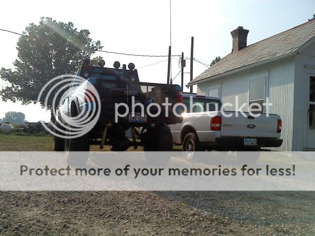

Figured I would post a few pics of truck now that it is finally becoming what I bought it for.haha

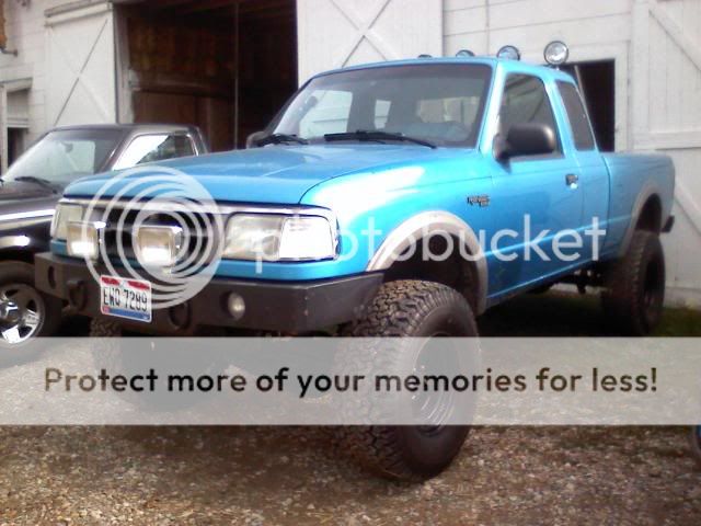

Here is a pic of it the day I bought it. Almost 2 yrs ago.
'95 Ranger
'95 Ranger

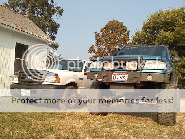

I drove it home stock and parked it. They next time I drove it... it was sitting on 33" BFG ATs and a 6" lift.

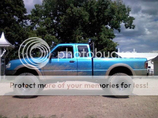

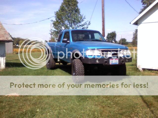

Here is how it I ran it for a year or so. 8" TTB lift w/ extended arms and D35 skid plate and Warn lockouts sitting on 35" Dick Cepeks

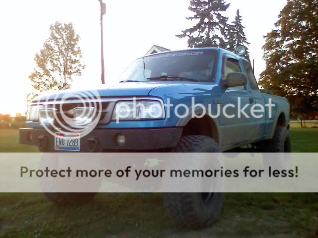

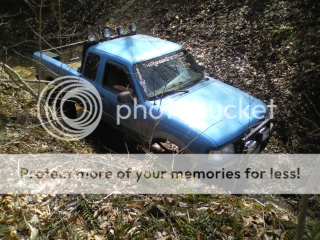

Then SAS 1.0, before I swapped the rear shafts to 5x5.5.

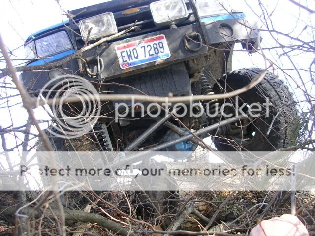

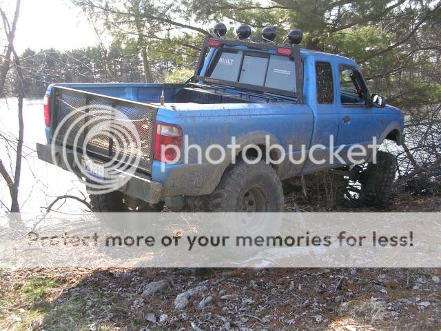

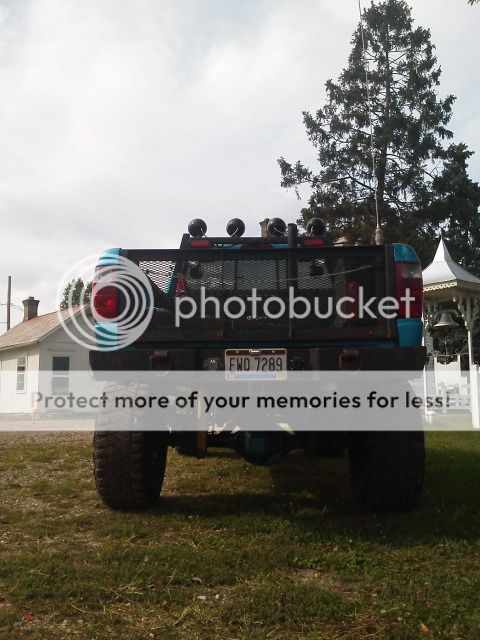

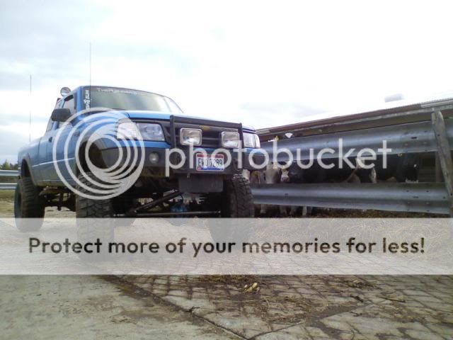

As of 10-12 (SAS 2.0, New coils, arms, etc)
