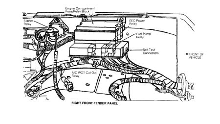

fuel pump relay, located near power box on passenger side, smack it with a ratchet a few times, they are finicky and like to stick, i buy LOTS of running rangers that all the sudden"need fuel pumps" for 250 or so and its usually the problem
Yes, fuel pump relay.
Small pic, but you can make it out
Where it says 'Front of Vehicle', that is actually the firewall. The front is towards the left

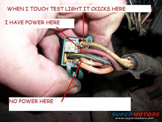

should the relay make a clicking sound?and what if the relay is good...what next...
my wife is bringing me a relay when she gets off work today...so we will see if that does it.
A bad relay could still energize (clicking sound), but it doesn't mean the contacts inside have not been burned out. Test with a DVM to be sure, make sure you have power going in and coming out of the relay, for test purposes, you can make a jumper wire to test and see if you get the fuel pump to come on, but I would not leave or drive it like this.
SVT
Red and yellow should be your coil wires, when you test the yellow with a test light, you are actually supplying a ground to the coil thereby energizing it (making it go clickity click), the black/yellow IIRC should be your power in (from the distribution box) and the orange/white (power out) will go to your fuel pump. Look to see which wire is coming from your distribution box for the fuel pump fuse, and this will be your color going into the relay. I don't have the diagram handy otherwise I could tell you which is what. Someone may chime in with the schematic...
