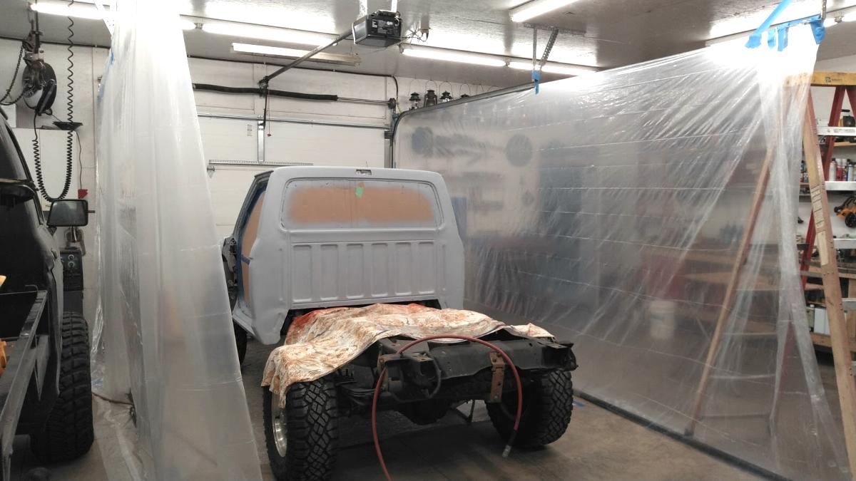

    Plastic – If you have access to a paint booth – great. If you are like me, it was the garage. Here is a very important rule to remember – if you don’t want it painted, cover it. Paint goes everywhere in your garage. Cover the floor and all the walls. Get cheapo $3 plastic paint drop cloths and staple or tape them in place. You’ll need about six of the big ones. If you want to re-use them later, get the heavy duty ones (they are about three times the cost). If you paint in your garage, assume you will get some dust and bug imperfections in the paint. I have found this unavoidable in the past. Note that in some locations, it is illegal to paint your vehicle outside or in your garage.

    Fans – Ventilation is key. You need at least one, and I would recommend multiple box fans taking air (and paint fumes) out of the garage. I utilized three fans my last time and this was a good amount in my opinion.
