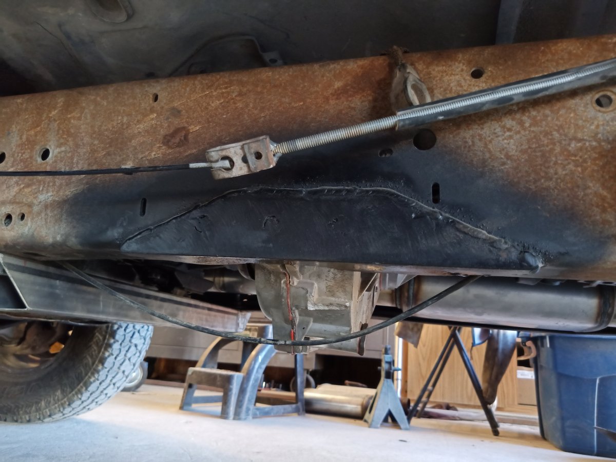

The NP 208 required frame rail reinforcement and notch, and a slight offset of the powertrain to the passenger side.
59183
59184
The slice is what I took out, about 1.5".

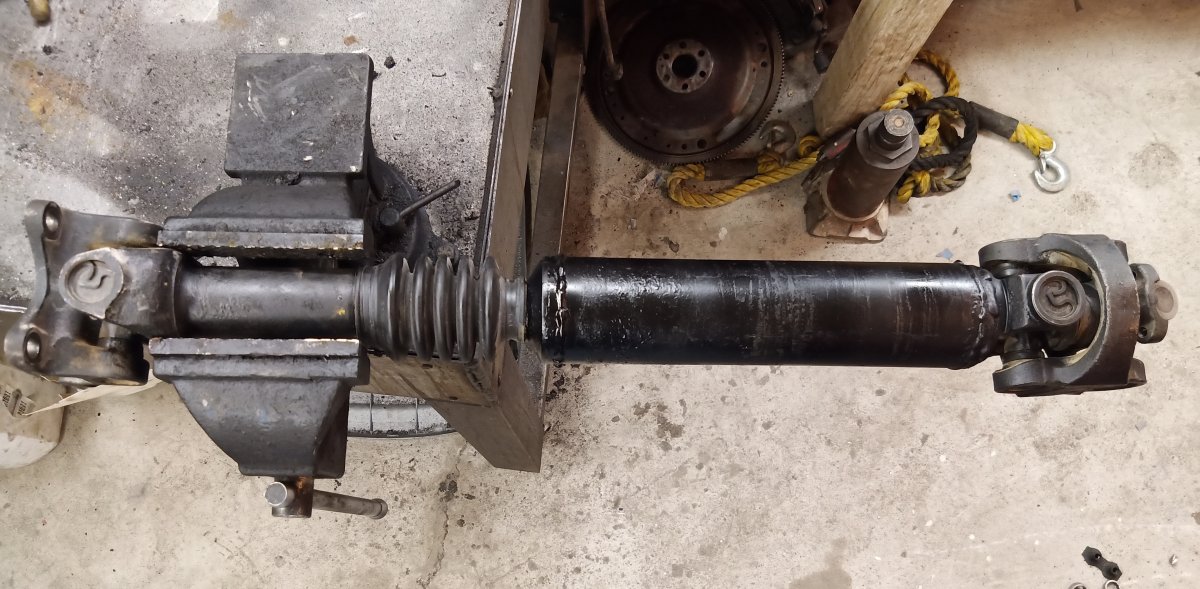

Driveshaft is starting to look like one out of a TJ, as short as it's getting...

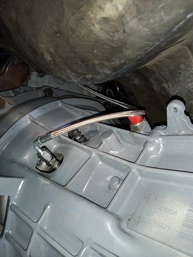

The AN -3 line worked great. More surprising is the clutch bled out in 30 minutes. Sometimes the integral slaves can be a chore to bleed.

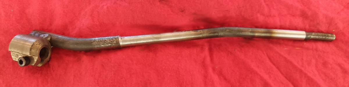

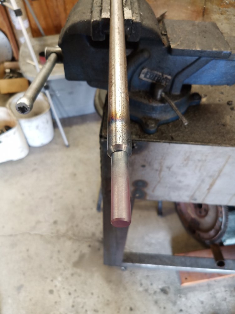

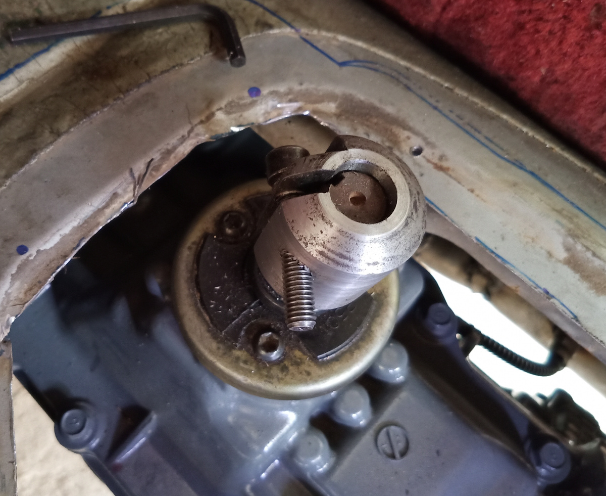

Shifter: I used an old pry bar for bar stock. Not the best choice, the carbon content was somewhere between spring steel and tool steel. I annealed and tapped one end to 12x1.75 pitch for common shifter knobs.
59397

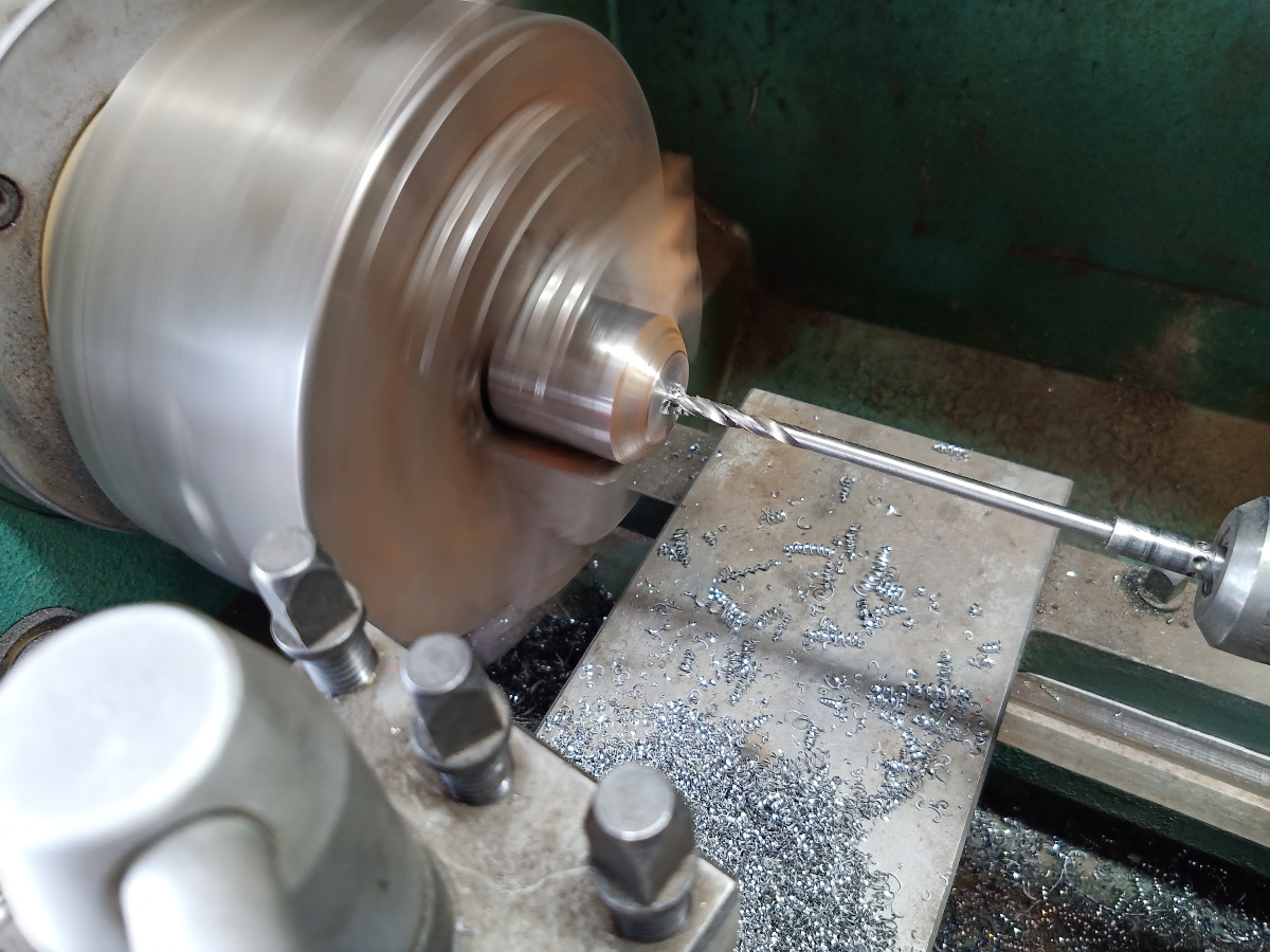

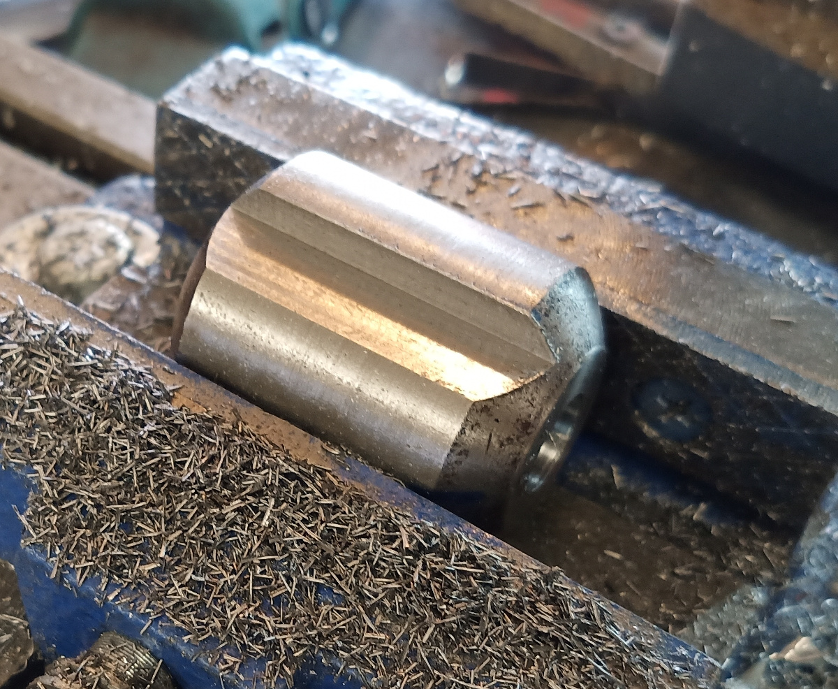

Shifter stub collar: Made from mild steel bar stock.
59398
59399
59400

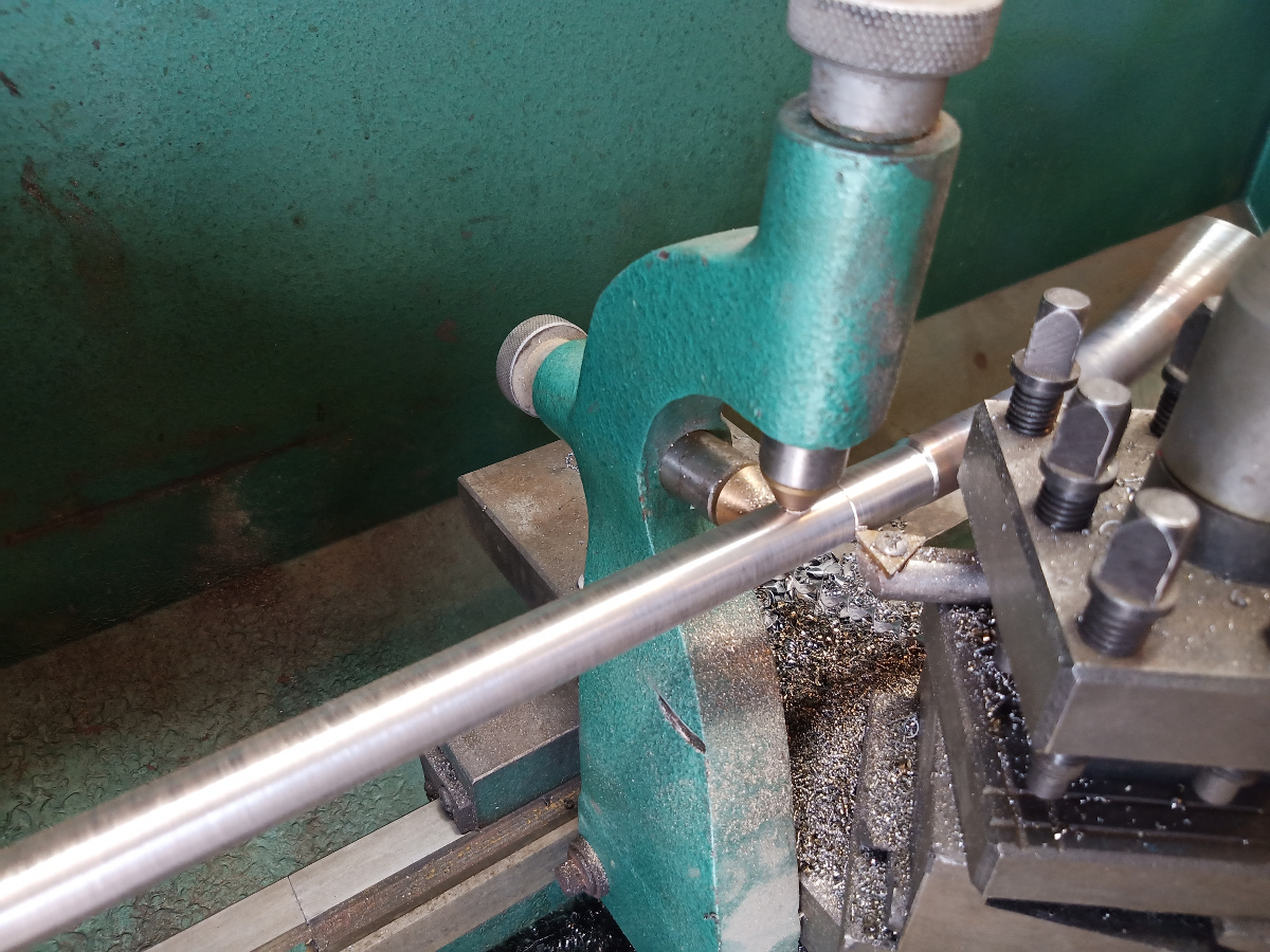

Diameter of the bar had to be reduced to fit through the hole in the shift boot.
59401
Completed shifter...

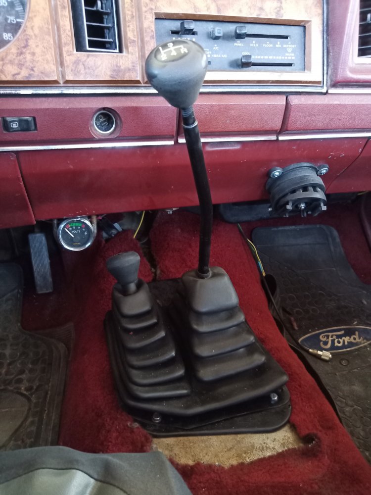

Installed in the Bronco...
59403
I had to move the shifters and boot forward, and patched the hole behind it with sheet metal. New carpet will cover it up.
I drove it to check syncros, all good. Trans is in good shape.
