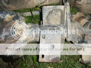

Here is a picture to show the brace work on the pass. bracket. I bent the sucker one time, and managed to repair it, so it got braced.

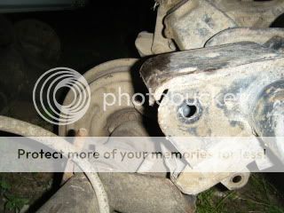

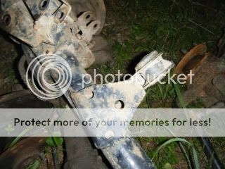

I might as well post the other pixtures showing how to "armour" the weak points on the D30:

Now, the way that MY D30 is "armoured", the OEM control arm bushings WILL NOT FIT, so you simply alter the design as needed. I run Terraflex bushings, as an FYI. They are smaller, but poly and have held up for over 7 years, without much complaint, other than the normal greasing every 4-5 oil changes (very thing else gets greased when I get back from the trip, esp. balljoints/steering.)
