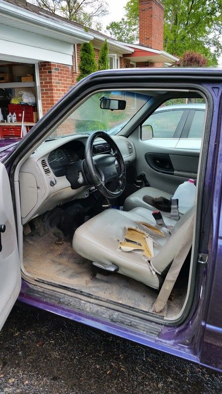

Rubber floor, vinyl type seats, one-piece rear window. *So I guess it was a base trim level of the V6 4x4?

Interior is pretty complete but very rough.

Clean it up (the bed cap is going), and find some better seats and interior trim parts...

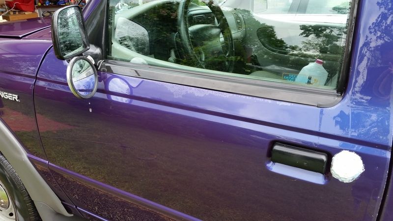

I guess the previous owner couldn't be bothered to get a replacement lock... And the circle mirror is being removed...
