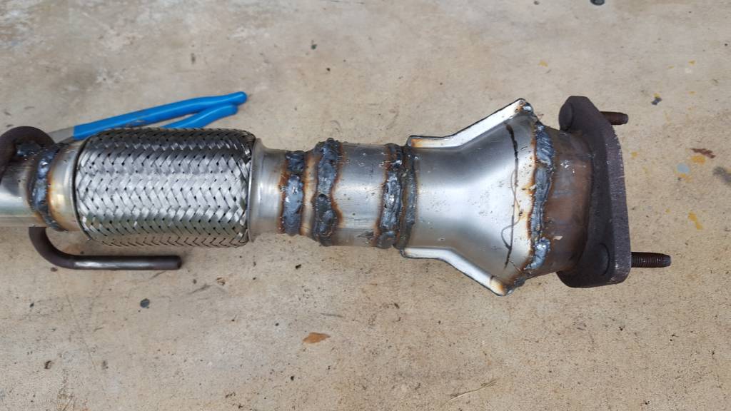

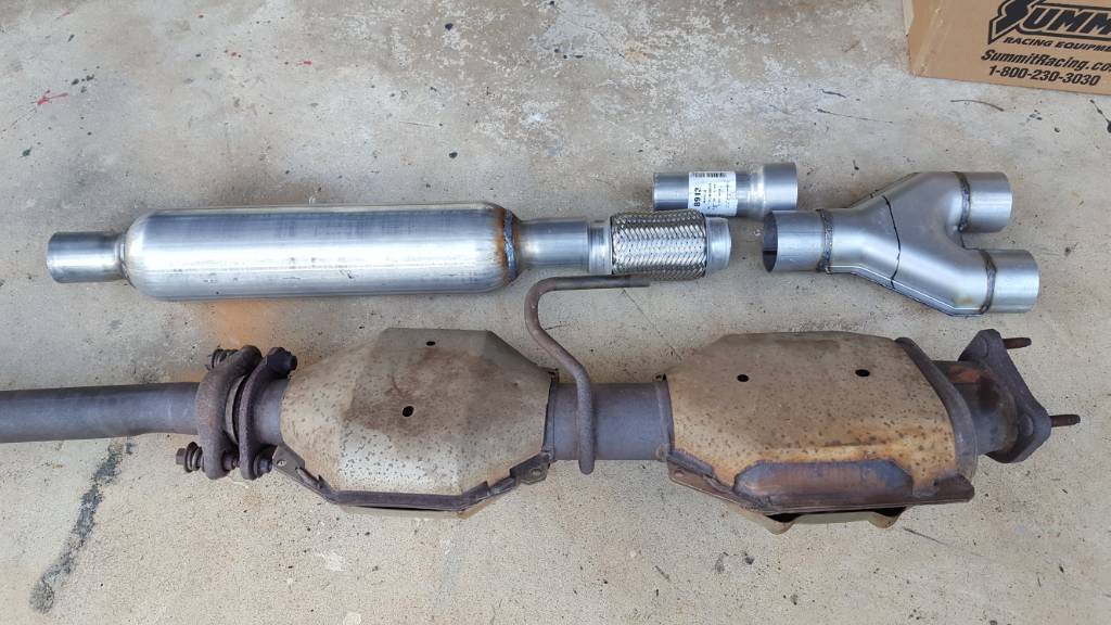

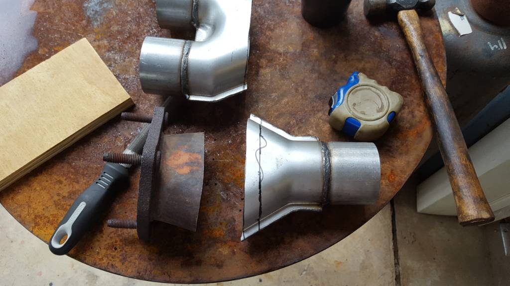

Well, here's my solution. It worked out well. Please excuse my sloppy welds.
