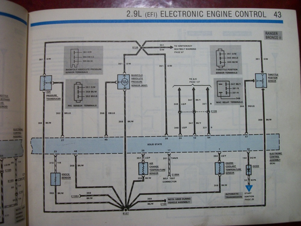

One question...i was just looking at a pinout diagram with a wiring diagram...and it shows all the sensors using the same signal return?? Pin 46?
That doesnt make sense to me. Id like to probe the return wire to see if the signal is getting back to the ecm

That is a nice schematic, but I wouldn't put 100% trust in one which covers multiple years. In this case, 1988 through 1991; and it's also showing a V8.
Yours is a 1986 model, right?
I can shoot and post the Ford EVTM pages for the 1986 2.9 wiring, if you'd like, but I'm not sure if I have the Powertrain and Emissions manual for that year.
I noticed it had 8 injectors and was 88-91 after i posted it. Funny when i did a google image search it said it was from TRS (here)...
Anywho yeah if you could do that thatd be great. Its an 86. 2.9 obviously. Sept 85 build date...so an early one if it matters.

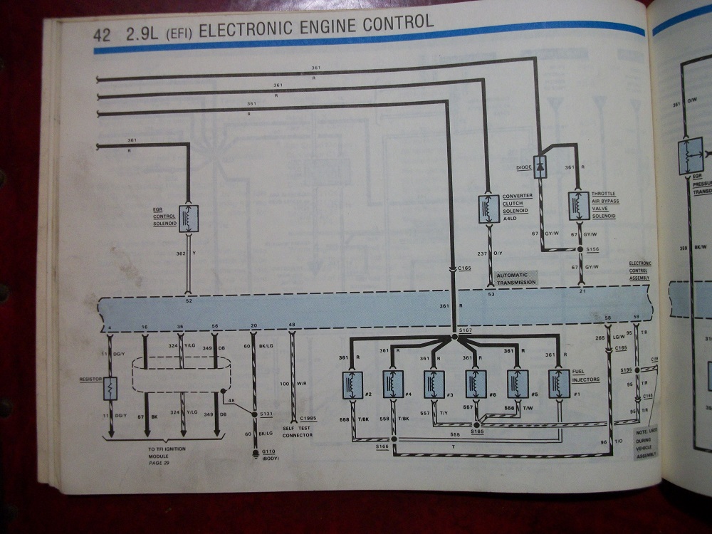

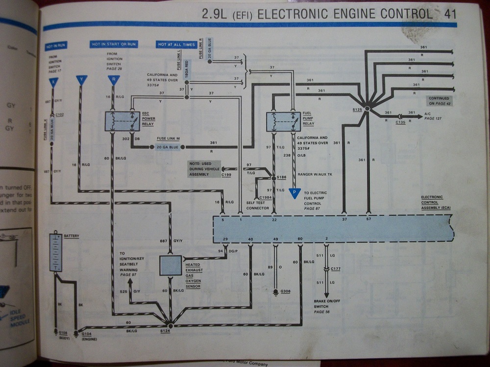

1986 EVTM pages; if needed you can download them so you can zoom in.
Troubleshooting individual circuits, ECT in this case (page 43, 3-3, lower right), would be in the Powertrain book. I'd have to check if I've got the '86 book.
Keep in mind, that 1986 was the first year for the 2.9, and yours is an early build date. As far changes, we'd probably have to compare to the '87 schematics.
So if im reading this right the green wire must be signal back to the ECM? Since the black wire runs to everything?
Yes. I'm reading it as Black/White is power supply, should be 5 volts, and Green/Yellow as signal return.
