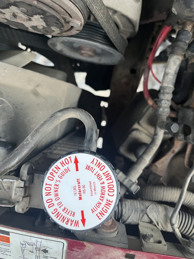

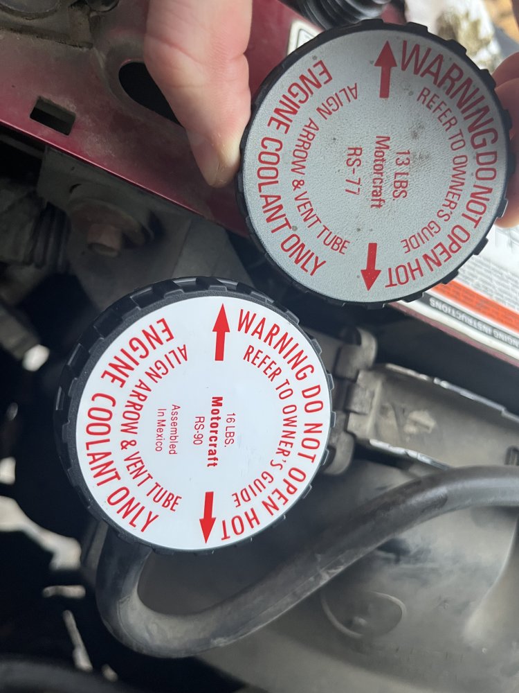

I preventively replaced my radiator cap today. Motorcraft replacement ordered from a reputable seller on eBay. Their tool indicated that it would fit my 1993 4.0.
upon installation, it looks to be a slightly different model. And while it nestles in cleanly, the arrows don’t match up perfectly with the vent tube.
can I use this cap. Or order a replacement with the same model number. Thanks!

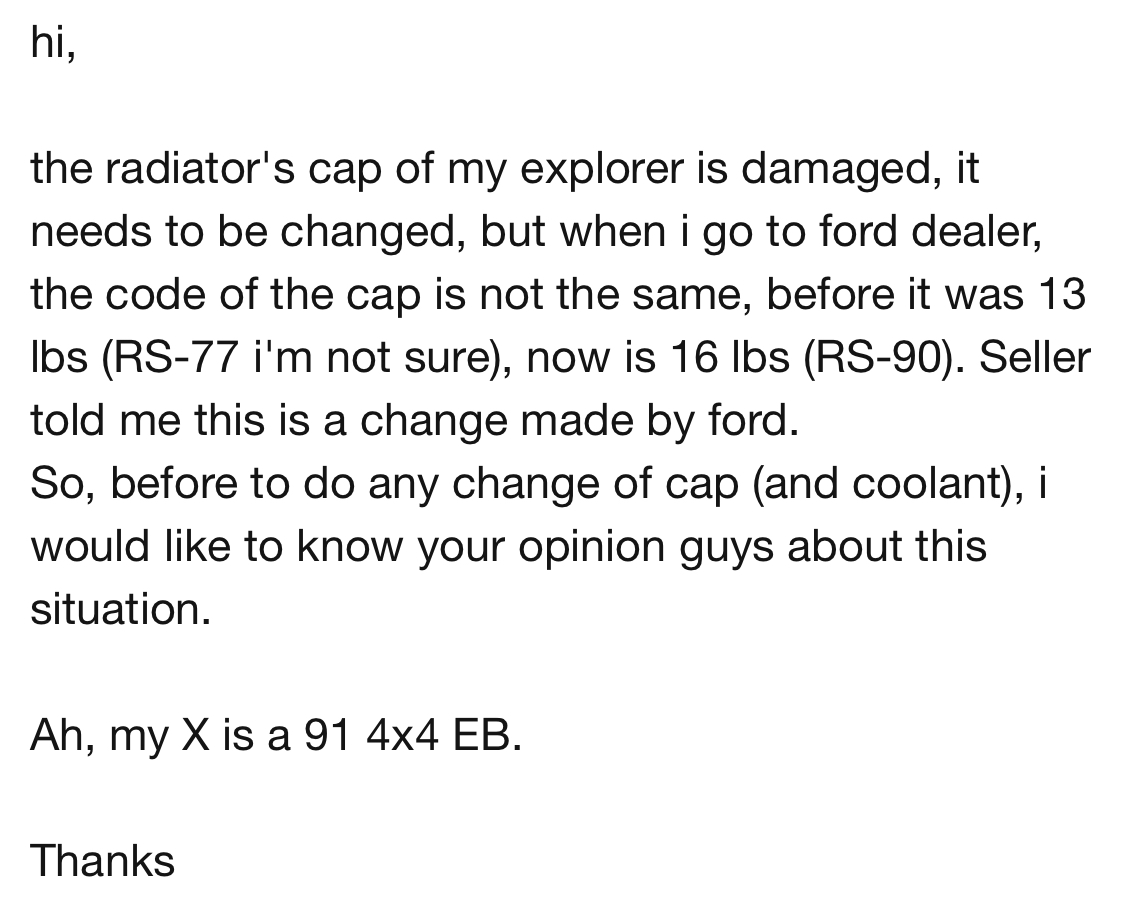

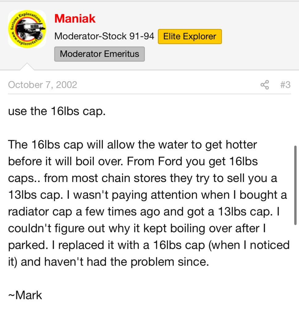

Potential answer from another forum. But I’d be interested in other opinions.

Id be more concerned the new one is 16lb and the old 13lb
Yeah seems like they don’t sell the rs77 13lb anymore. And the forum screenshots attached above suggest they may have been changed by ford from 13 to 16lbs.
