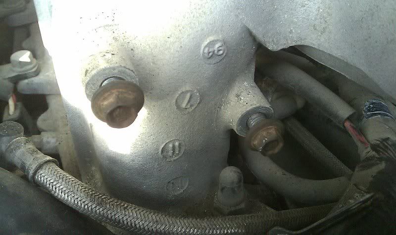

Since my donor had an auto in it, I kept my original FM-146 transmission. I ordered a new 4.0 flywheel, 4.0 slave, and 4.0 clutch kit to make it work with the new motor (I found out after that the 93-94 slave cylinders have a different fitting than the earlier years so instead of buying a another slave and dropping the tranny, I chose to buy a 94 master cylinder and clutch line for a little over twice the price of a slave, but I didn't have to drop the tranny again so it was worth it to me.)

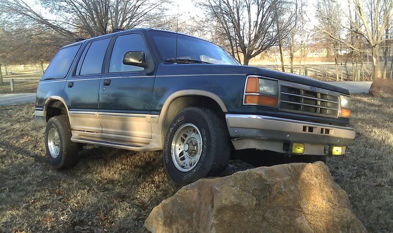

The Donor:

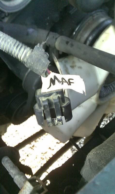

Remove and mark all plugs that are before the main harness plug, ie: MAF, alt, headlight plug

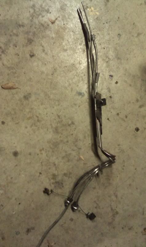

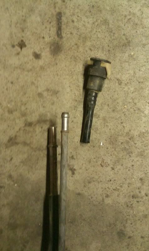

Before dropping the motor in, swap the fuel lines from fuel filter to disconnects with your donor (I did this after the motor was in. It would just be easier to get to.) The disconnects at the motor are not the same between the 2.9 and 4.0.
Now on the filter end, the return line on the 2.9 is female, but the 4.0 is a male.
There are several ways to go about this. Here is what I did. I cut off the female end and slid it on the 4.0 lines and added a hose clamp for security. If you do this, heat up the metal line and slide the plastic over it. If you heat the plastic, you could deform it and may not seal. If you go this route, use a 4.0 fuel filter. The lines wil connect to the older one, but the nipple on the filter is not as long and you wont be able to get the removal tool behind it to remove later.
Also keep your existing line from fuel tank the charcoal canister unless you swap that out also. You'll have to extend the line from the TB to the canister if you don't swap them.

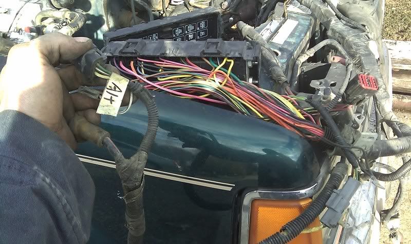

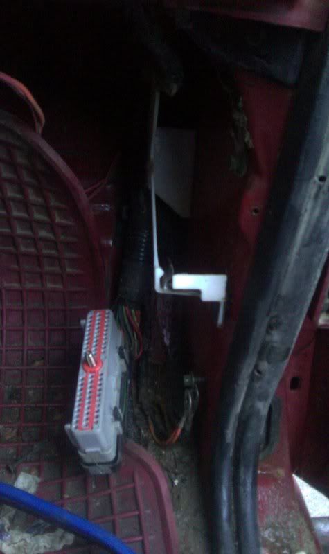

Pull the 4.0 engine harness. Everything should unplug until you get to where the distribution box meets the headlights next to the battery. Cut here keeping the alt, starter and solenoid harness. Others have used the 2.9 starter harness. I found that it didn't reach the 4.0 starter so I swapped it out. I also used the 4.0 alt harness. I had to cut one wire that went into the headlight harness, but I just spliced it to the same wire coming from the 2.9 HH. They were both a Grn/R wire. Pull the 2.9 harness the same way but dont cut the wiring yet. With both distribution boxes next to each other, cut the wires off the 2.9 box one at a time and wire them to the 4.0 box accordingly. I wired together the power doors, headlights, and interior fuse box. The EEC on the 4.0 harness (grn/red wire) needs to be wired to the ignition switch. I used one of the spare fused links in the distribution box temporarily to get it running. I could not get the fuel pump to kick on when wiring it to the 4.0 harness. Not sure where it ends up coming out at, but I ran a wire from plug on the driver fender (pk/bk wire) to the Grn/Y wire on the fuel pump relay. You will end up with a bunch of spare wires that you can use to fuse extra lights, winch, or whatever. I made a sheet with the wire color code and fuse location so I could identify them later. These must all be taped off since the box uses a common power, they could ground out. There is a 2 wire plug coming out of the harness near the battery also. One wire is black, the other is Bk/W. These must be grounded.
As far as the driver fender wiring, use The Bronc's diagram here:
http://www.therangerstation.com/tech_library/EDiagrams/files/BII4Lswapwiring.JPG
He swapped from and unknown year Ex to an 89 B2 so the wiring on the truck side was the same. The Ex side was also for the most part. One or two that were different, but easy to figure out. Also one of my plugs were brown and his description says grey.
I cut the connectors off both ends of the unused harness and did most of the splicing there so if I needed to remove it later it would be easy.
On the Ex auto harness I spliced together the R/Lt Blu and Pink wires in the cannon plug to bypass the neutral switch. I have yet to wire in my reverse lights. I'll update with colors once I do.
Make sure to solder your spliced wires. You don't want a short down the road that you have to track down.
