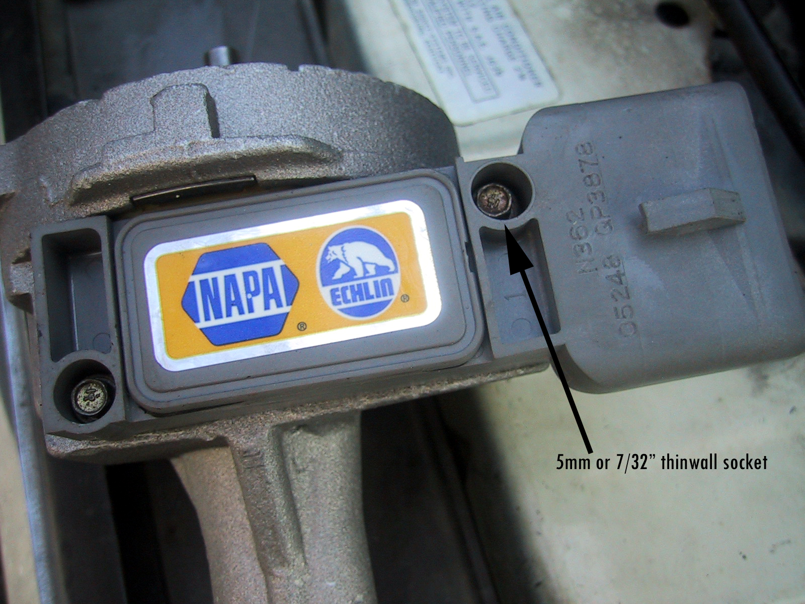

replace the TFI module on the back of the dissy.
do the distributor have to come out for that? is there any special tools req'd
get the TFI tool from autozone, it'll save you headache.
(well, whatver you guys have in the great white north)
just put your arms around the engine, reach around behind it, stick the 5mm thin-wall socket end of it into the holes on the back, take the screws out, pull it directly down, pull it around the engine once it unplugs from the dissy, then disconnect the wiring harness and put a new one in by reversing the procedure.
i did it in the napa parking lot in five minutes and i'd never done it before in my life.
would it make it any easier to remove the dizzy cap?
nah, no need, hold on i'll get you a picture of what i'm talking about, the cap can stay on
it's just like this, you just gotta do it with your arms around the upper intake and it's facing the firewall, taking the cap off would be more work than it's worth.
that was a big help lol thanks i even got the part number haha
how much are these?
35 dollars give or take.
