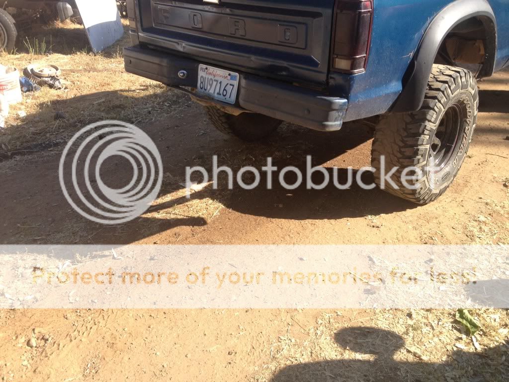

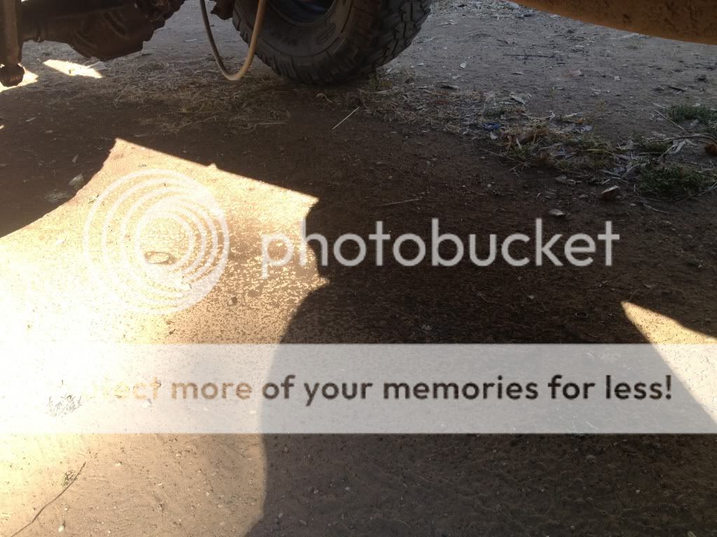

I went to start it up this morning and it started spittin water out of the exhaust, and by the monifold, the oil looked like peanut butter. So gotta tear it apart and see how many arms and legs I'm cuttin off. Here's the pics:

Yeah me too I might get lucky and it just be the head gasket. If not then I guess I'll rebuild it.
Try running a compression check first! It may be a intake manifold leak. I had the same thing happen and it was the manifold gasket.
If I get a gasket set wouldn't I get the intake gasket too? So I could just replace it then and see if it is blown. Either way I'm thinkin the motor is gonna have to be torn down because of the way the oil looked.
That's not good. Water got into your oil. Do a gasket swap, including the manifold gasket that Fitzgerald was talking about, and change your oil. Then try and start it up.
If I'm gonna be doin gaskets shouldn't I check the heads while I'm at it?
