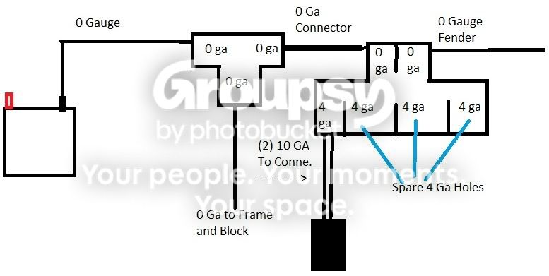

I went out and looked at the engine bay, what all i would need and lay out space... this is my positive lay out that i am gonna follow
and this would be the negative lay out..
Ive gotten rid of the A/C components so some of the air will flow better. engine bay doesnt seem to get to hot and all wires and parts are name brand. ive already got about 30 ft of 4 ga wire and friend of mine can get 0 ga for pretty cheap.. all ill have to do is where terminals need to go are buy terminals and solder
the db are water proof, rust proof etc...
