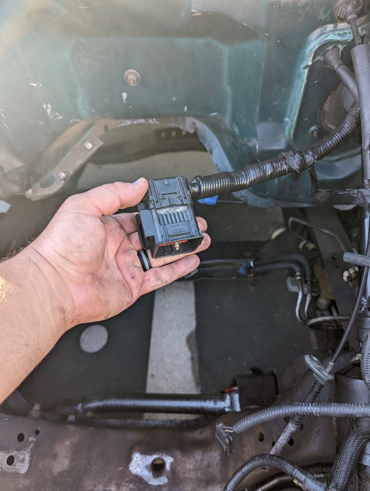

I am currently building a 302 from a 1995 Mustang GT. I have a megasquirt plug and play ECU and the wiring harness, not including the fuse box, from the 95 Mustang. I need to figure out what I need to do to get the wiring harness from the Mustang to work with the harness from the power distribution box that's on the Ranger. The Ranger is a 1995 XLT 2wd.
I'm and trying to get the wiring harness I have from the 94 Mustang GT to work with the harness for the Ranger. Does anybody have any info on what I should do to get it to work? I've heard just PCM power and fuel pump power. The only thing I can find info on it for a 92 mustang harness into a Bronco 2 harness.

Sounds like you need the EVTMs for the Ranger and for the mustang. Should be available on ebay.
