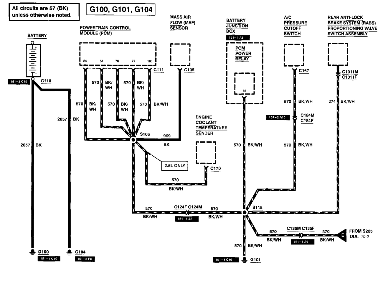

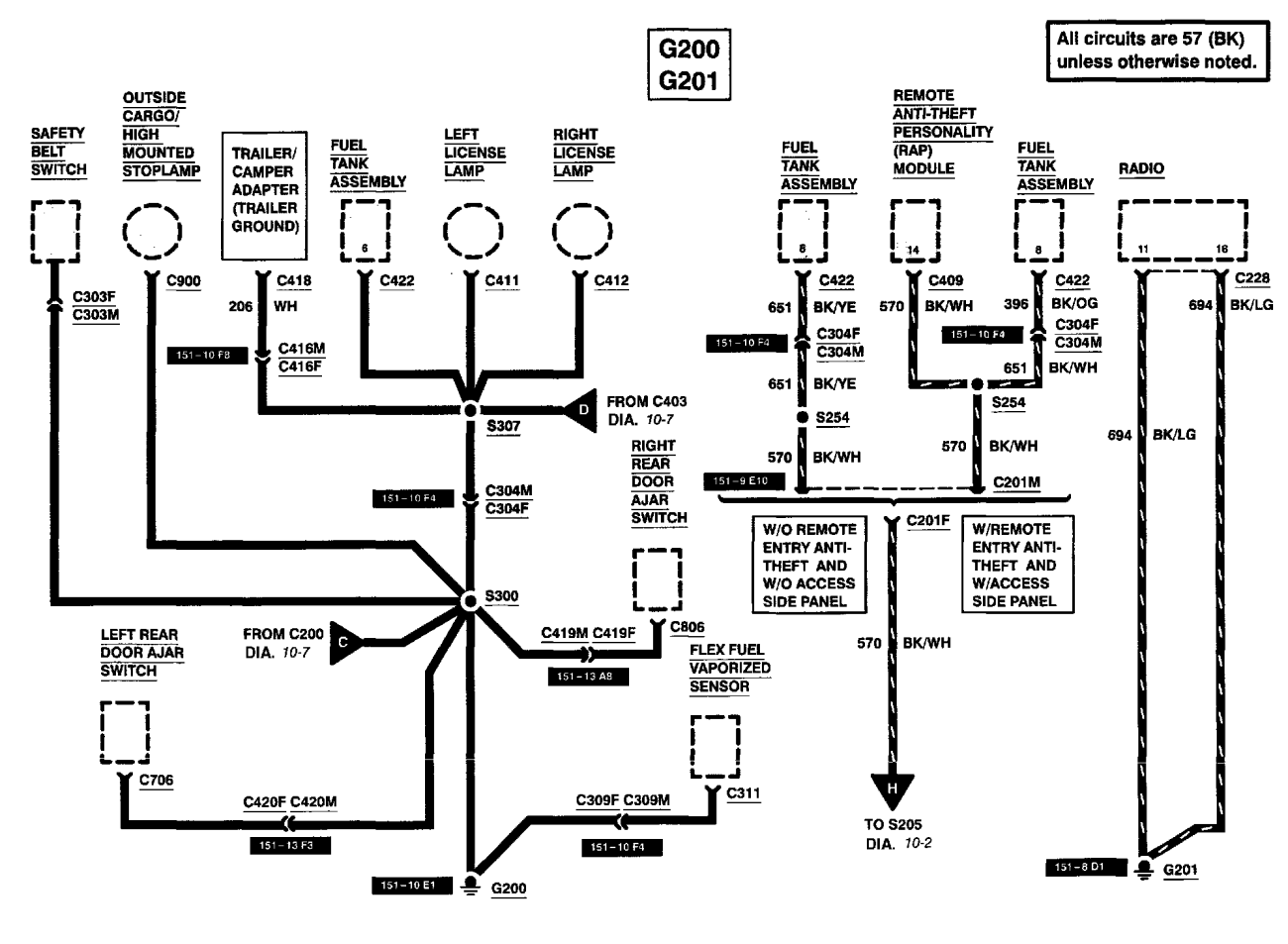

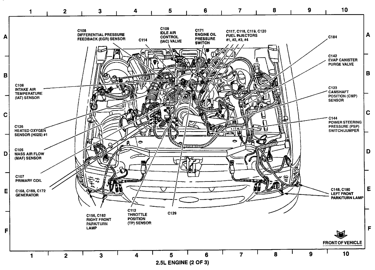

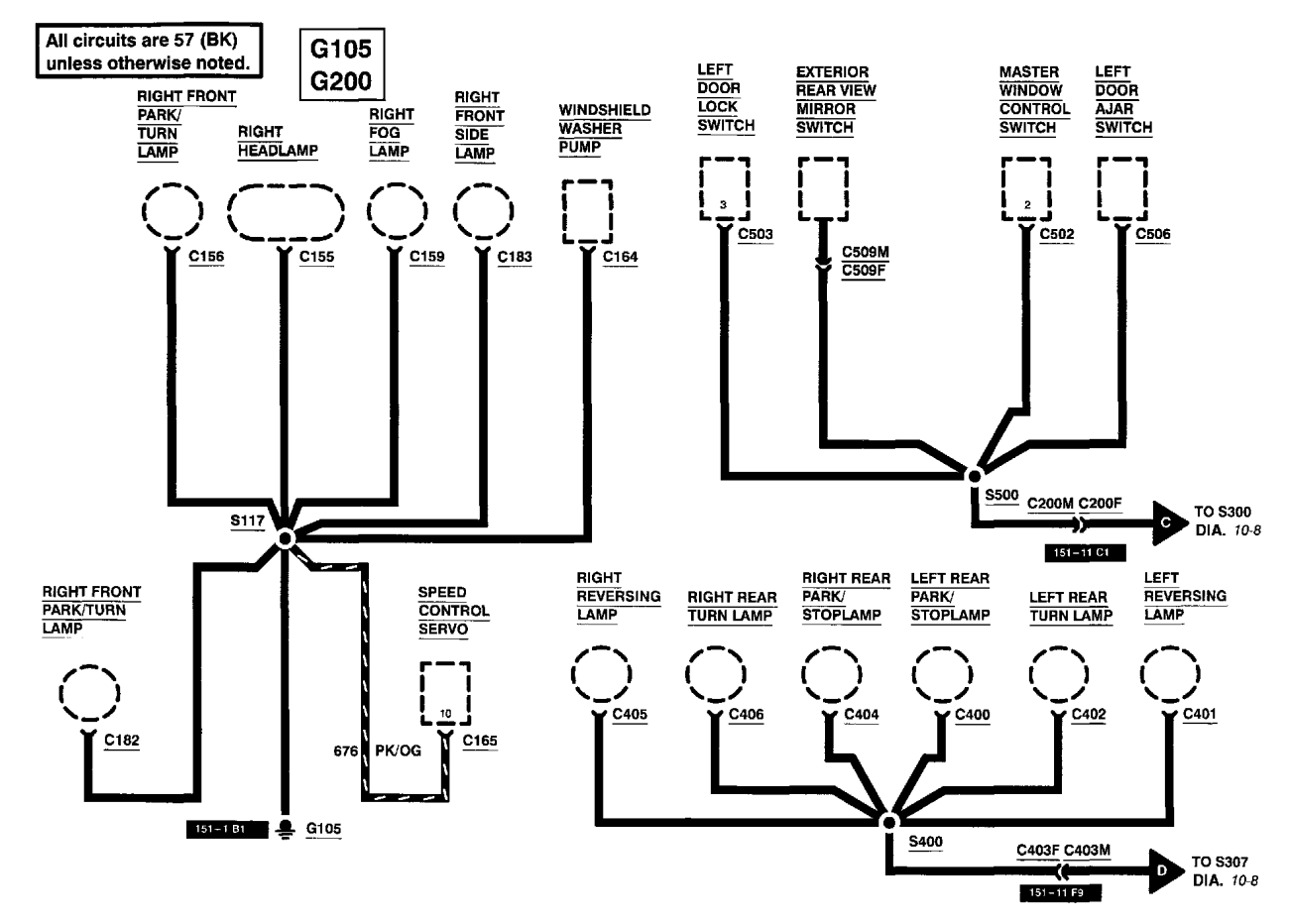

Hey guys in a bit of a pickle. Fully took out my engine and tranny ( 1999 ford ranger 2.5l manual transmission ) to do a slight rebuild and I got everything back in but I’m having a hard time remembering where ground connections are ( I should’ve taken fotos of everything but it just went over my head) , where the wiring harnesses kind of are placed so I was wondering if y’all have any info like graphs, wiring diagrams, actual fotos of where the grounds go and how the wiring harnesses are placed in. Sorry for the bother appreciate the help
grounds
Ground listing and harness views
