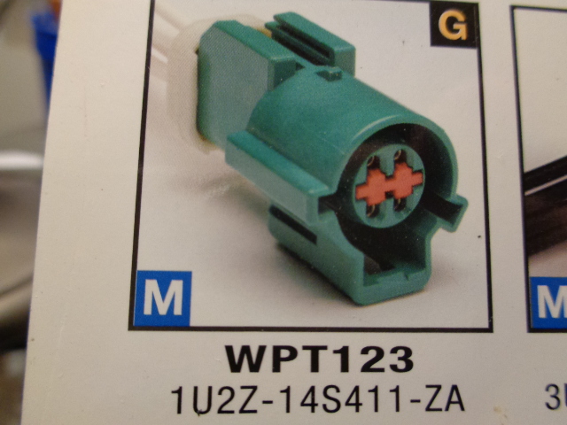

Is this the connector you need?? If so, I believe it is still available, via this WPT number!
33553

biggest problem with this is room to work. going to try fishing the pigtail up to the top of the motor to see if there will be room to get at it. i don't want to get a pin in the wrong spot.
looking at the o'reilly website, they mention 4 wire sensors. the dead one has 3 wires. don't know yet what's on the harness end but the doner has 4 going into it (think this harness came out of a 91. definitely a series 2 anyway. was just a cab, no motor etc)
