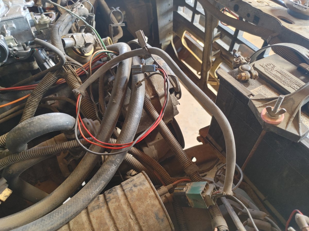

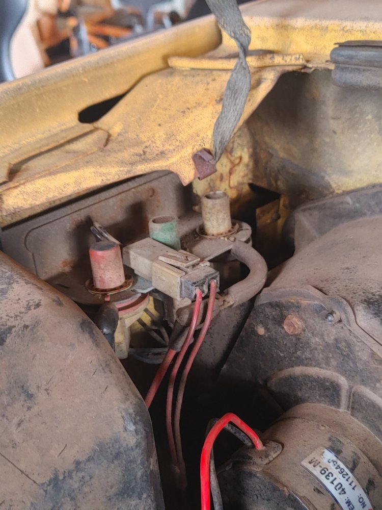

Choke wire is original. I'm guessing the loom would be something to do with an A/C option. Not a single one of the wiring diagrams I have seen show the charcoal canister solenoids or wiring. My best guess is the large wire would have gone to the A/C clutch. 20231015_084822_HDR.jpg
