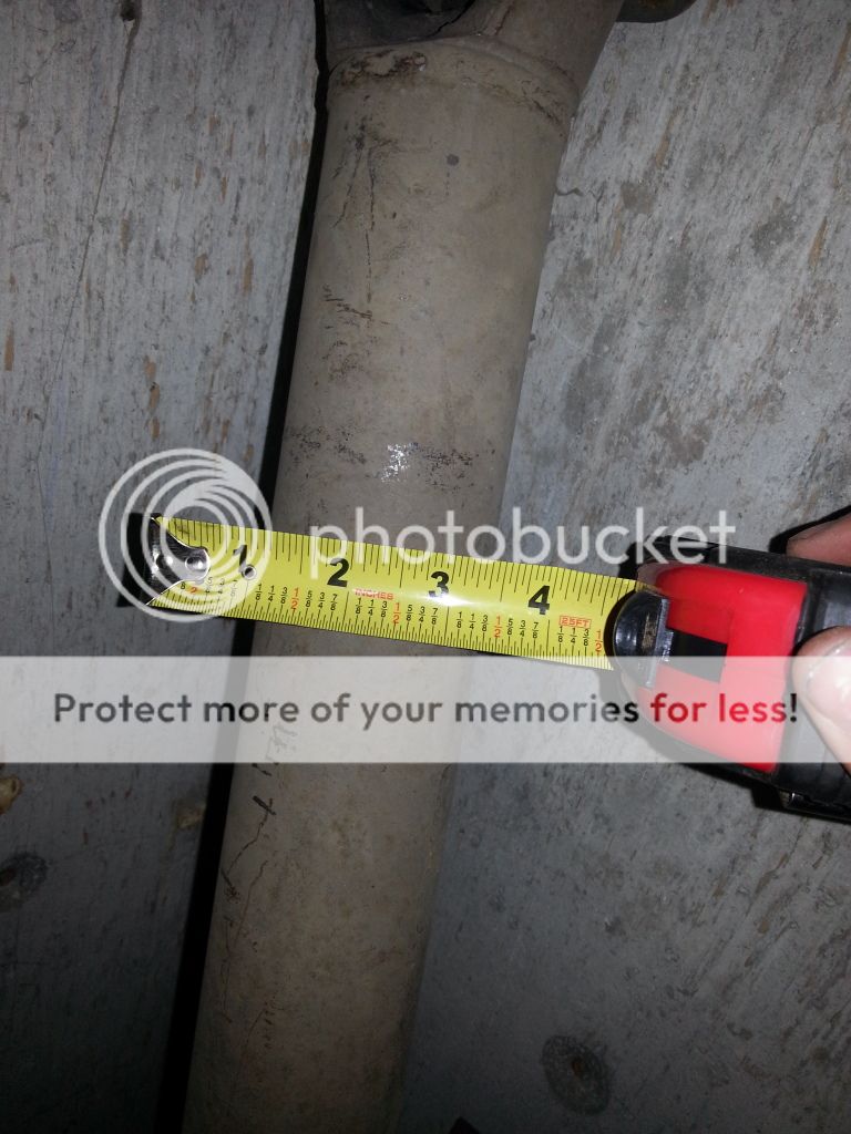

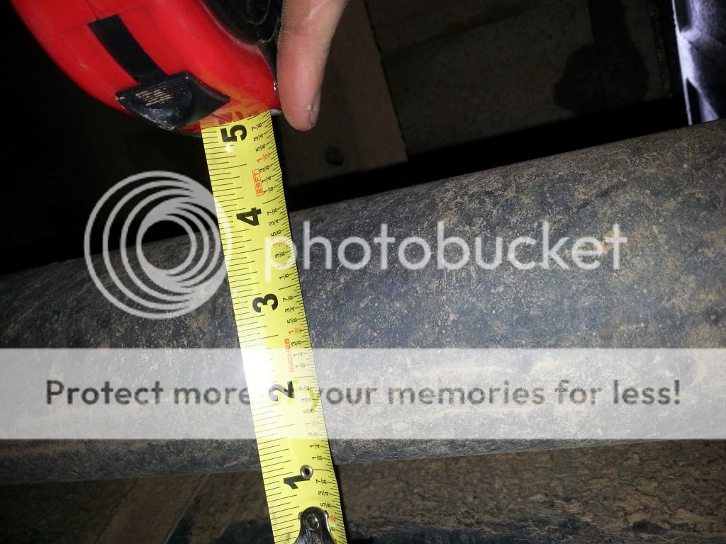

The skid plate only becomes an issue if you end up with an aluminum shaft, because they are so big around. The steel ones are the same diameter as the two-piece.
2 piece
1 piece
There is atleast a 1/4 inch difference. You can see it without the tape measure. And that is not a aluminum shaft. It just bolted in the aluminum shaft needs adapters.
Eh, whatever, its' close enough. I don't have issues with mine.
