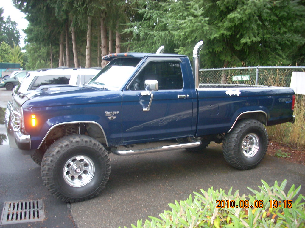

I know this one's for sale, but the owner wants $20K for it.
