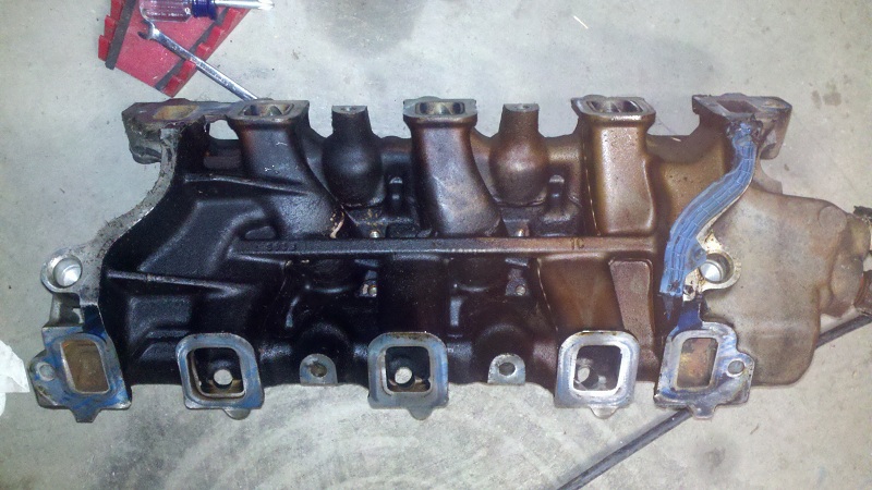

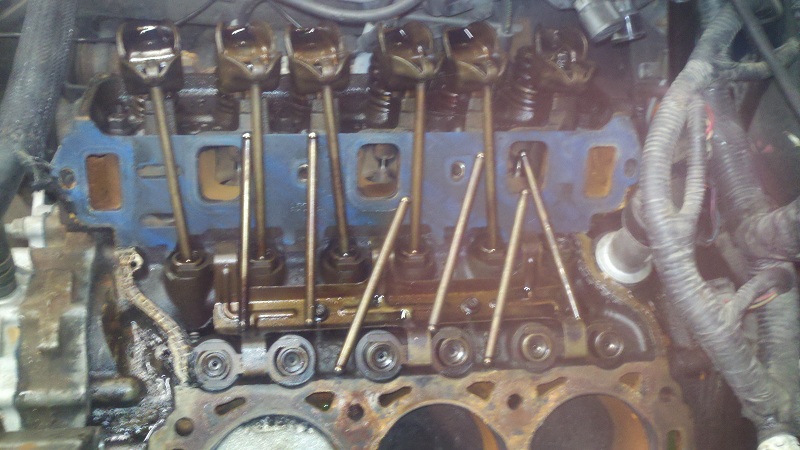

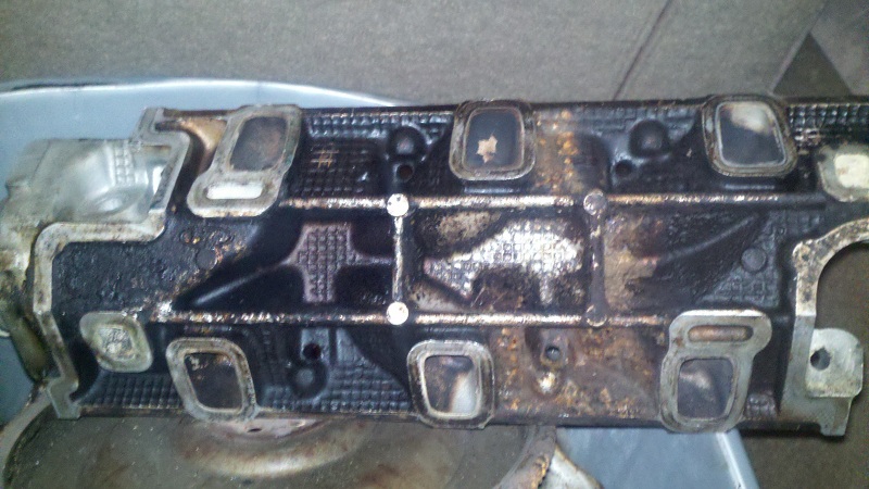

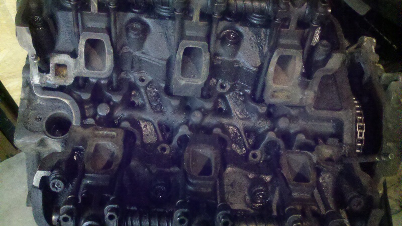

Here is some pics i believe what you are sdaying im just confused with what i have.

the first pic is the 94' lower, the second is the 94' engine, then the 2000 engine, 2000 lower, and the 94' block numbers for what ever reason
They didn't make the 2.9 in 94. If it was anything else it'd be a 4.0. Compare your pics to here:
http://www.explorerforum.com/forums/showthread.php?t=243297
I've not worked with a 4.0 but it's looking like that might be the case, based on the lower intake - block bends. 4.0s had EDIS, so if you have a coilpack, that'd be a dead giveaway; a 94 3.0 will have a distributor setup. They also had different valve covers; 3.0's have always had plastic that said 3.0 on them.
i know, i think its an older engine. i am going to talk to the guy and get my money back and start over since it will not work anyway..
