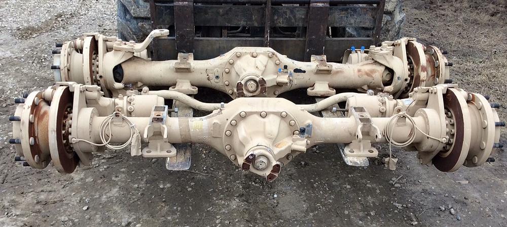

I need some help, not sure if it's real or not. I'm looking to find a make that had a 4wd front axle with a center pumpkin but am starting to doubt it's existence. Needs to be steerable. Or! A steerable rear axle with center pumpkin

There really isn’t much that isn’t offset until you get into the heavy truck stuff.

An enterprising fellow with a fat wallet could custom build a center diff steerable axle by shortening one axle tube and lengthening the other then getting custom shafts…

GM put some of those on full size pickups a few years ago.
a centered front diff/pumpkin/driveshaft would be directly under the engine. that would need a lot of extra room.
