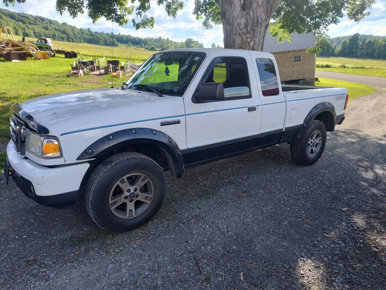

My truck is very wiggly and jiggly, it also hops around. Any thoughts? The rear shocks are new, the frame is not bending/crossmembers are not shifting, and the axle is firmly installed.
It seems all of the wiggle is coming from the tires having big sidewalls.
It almost feels too unsafe to drive over 45 with how loose it feels (wiggly).
My steering is solid, tires are new, front stabilizers are good, and rear shocks and shackles are new.
(Sorry if it's hard to see in video, but I'm pushing on the rear of the truck and the front pivots to a wiggle).
