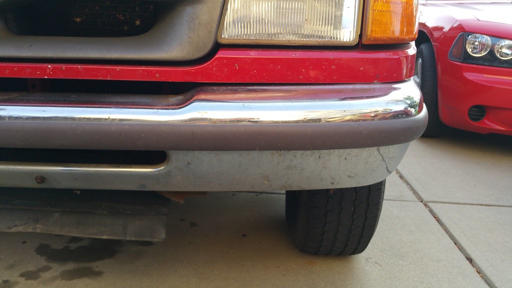

She wasn't hurt and no one else was involved, which in itself is amazing since it was on 465 in rush hour traffic. basically the cars in front of her came to a sudden stop and when she realized it, it was too late and she panic stopped and slid right into the guard rail. hooked the trucks bumper right on top of it.
Prognosis:
After unhooking it from the guard rail, the truck drives fine, but the steering wheel is now canted at a 5 or 6 degree to the left while driving straight. it does not pull to any one side and drives fine. A/C even still works :)

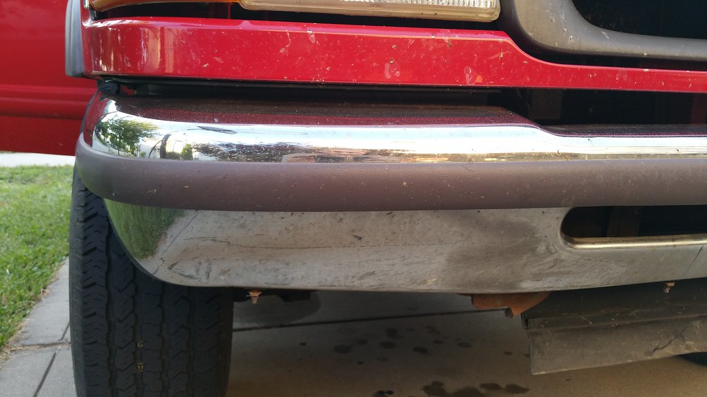

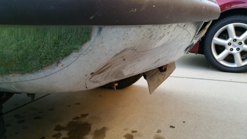

The bumper is bent. not bad, but definitely bent and pushed in on the passenger side. valence panel is in the bed of the truck, basically in one piece but probably not worth trying to reattach. license plate frame is gone...but not needed as IN does not need a front plate. part of the core support on the passenger side is slightly tweaked. frame rails look fine. the bumper is up against the frame rail on the passenger side.
And now, before I show the pics and mayhem, a request for those that have a 93-97 4wd Ranger (stock) can you take a look at the pics of the steering linkage and tell me if the drag link or inner tie rods look bent more than they should be? maybe post up pics of yours for comparison..

So what do you think on the steering? just take it to an alignment shop and hope for the best? replace the tie rods and drag link? The steering other than being off center seems to work fine, but I am probably going to wear teh tires out if it is off...

When someone hit ne in a parking lot going 10 mph. They hut me right in the passenger side front wheel and the steering wheel was off by probably 110 degrees. It drove just fine and even did 55 with no shaking. Turned out the steering gear box shaft actually bent throwing everything off.

you do need to get under there and do a through check of all front end parts including radius arm bushings and arms...

That doesn't look like a whole lot of damage to me, well beside the bumper that is. I can take some pictures of the underside of my 94 4x4 tomorrow if you'd like something to compare them to. I understand the gearbox is sensitive to jarring forces so if the Ranger hit near the pitman arm you might've had some damage to the gearbox itself causing the steering issues, but I'm not really knowledgeable enough to know.
