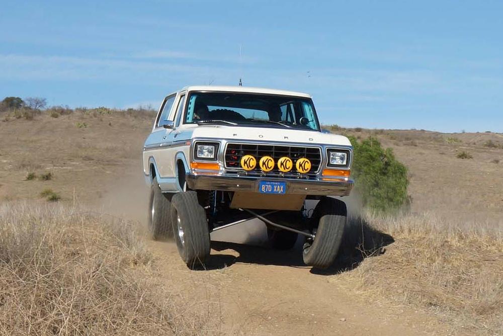

Really the only bad thing the TIB/TTB suspension is... It looks like you got kicked in the twins when its off the ground...

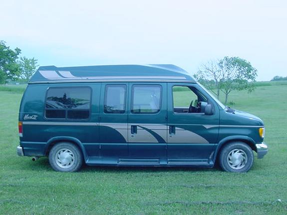

I had a 94 E150 Mark III conversion at one point...and dad had a 78? I think club wagon when i was preteen/teen.I liked the hell out of mine. A 73 Econoline E300 Super Van with a straight 300 Six I bought in 1978.
It had 10 ft from back of drivers seat to inside back door. For years I traveled around with an easy chair behind the drivers seat and a box spring and mattress back there somewhere.
