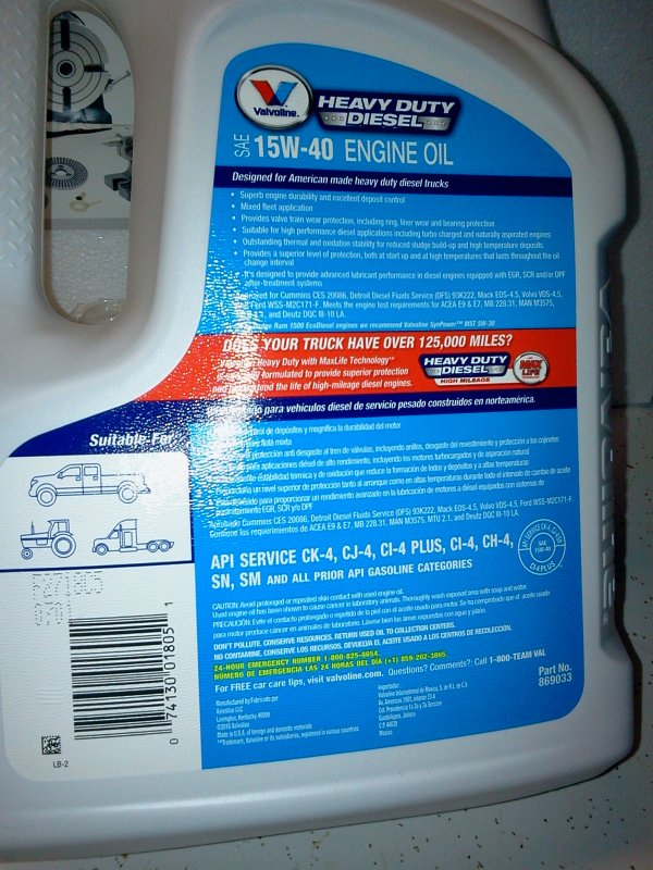

some diesel oils are rated for gasoline engines. and it's cheap at Walmart.

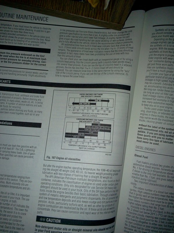

for us old school guys. from a Chiltons manual.
older owners manuals had these charts in them.
I'll run out for more popcorn now.

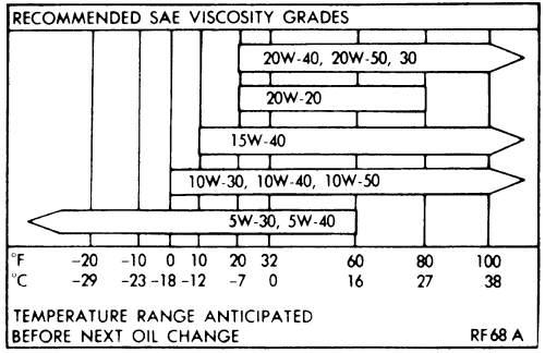

You can find several different charts online like this one. I can see why @Ranger850 doesn't want to use 5W in Florida. I personally just put whatever oil the manufacturer recommends, and call it a day.
