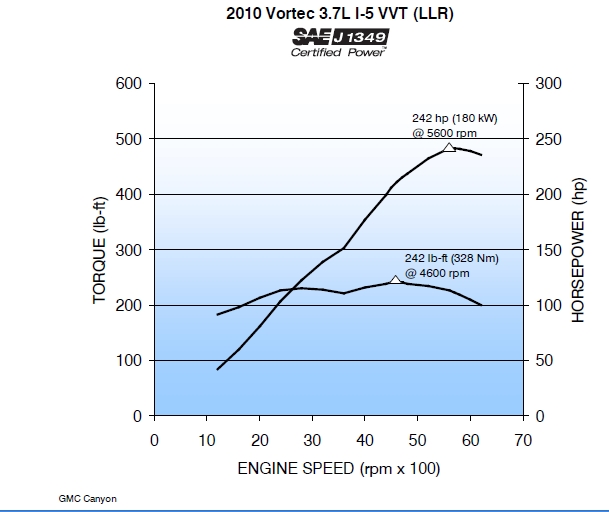

The Colorado's 3.7L I-5 makes:
242 hp @ 5600 rpm
242 lb-ft @ 4600 rpm
Redlines @ 6300

So I have substantially less horse power at a slightly lower rpm, but I have about the same torque at a substantially lower rpm. Torque is the number that matters here, and more torque at lower rpm is better.

The problem with looking at the peak torque--the Colorado is pretty strong down low despite them using their 4,600rpm figure.
attachment.php
