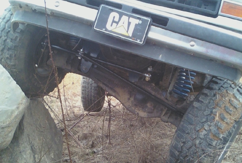

The stone crusher setup is not a k style setup, it is still a y style but the joints are heim and the pivot points are made to line up with each respectable beam. It is also made from 1 1/4" O.D. tubing...plenty beefy for most applications.:3gears:
The pic here was sent to me by Stone Crusher Seering. It is on an Explorer with the James Duff 5.5 stage 3 kit. Running 35" tires and a standard drop pitman arm. Reports no bump steer and speeds in excess of 70-75 are nice and straight. He reports that this is also without a steering stabilizer and that most of his customers are not reinstalling stabilizers because they aren't necessary. To me...it looks like the biggest improvement besides the heim joints and heavyness of the stock is that the pivot point for the driver's side beam tie rod is right in front of the driver's side pivot bracket which allows the rods to move in phase with the beams.:yahoo: To me it far surpasses the kit made by superlift in both design and durability...hands down. If you email him...you will find out that it also beats superlift in price to!:icon_thumby: You'll have to email Anthony at Stonecrushersteering.com to get pics and details etc. I tried to add the pic he sent me but it wouldn't upload.
Thanks bonedoc, this is the info I was lookin' for. I'll email stonecrusher tonight, better steering is the last hard part I need for my project.

Nothing but a stiff RBV TTB coil will fit in JD's coil mount unless you wait and get the new dual-pattern coil buckets they've recently been working on.
FWIW, I prefer the bushings over rod ends because mine still sees some amount of street time (and will last longer in conditions where mud & water are present). Unless you run flexier coils and longer shocks, the rod ends would be of little benefit anyway.
