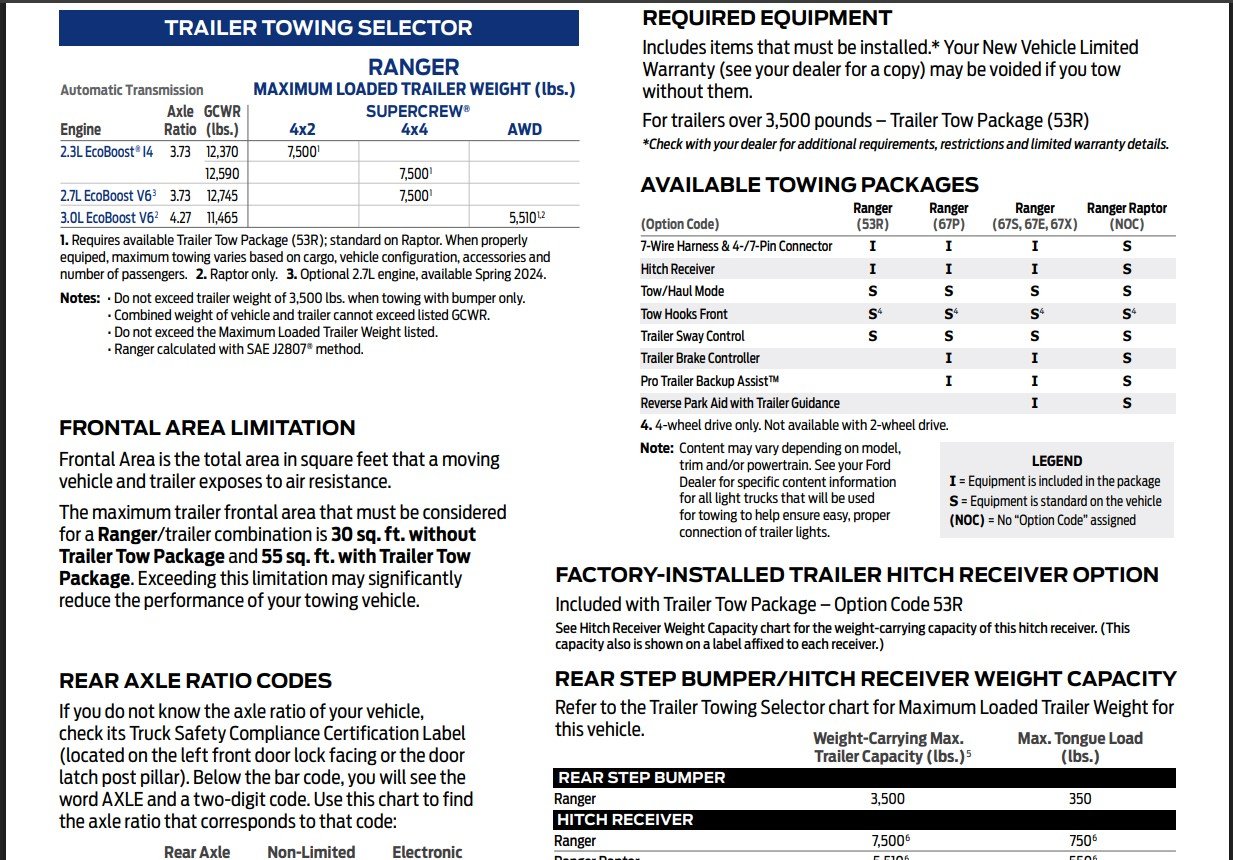

Is the factory transmission cooler sufficient for towing say 4,500 lbs on mountain grades or is an after market cooler recommended?

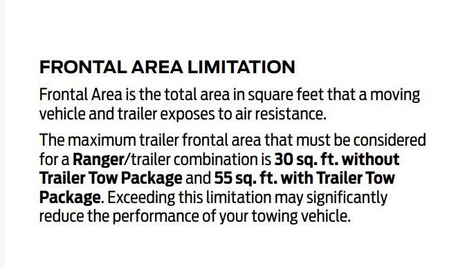

Also I don't understand this "frontal area" statement, why would a not having the trailer tow package "significantly reduce the performance of your towing vehicle"? All the trailer tow packages include are things like the hitch, brake controller, backup assist, parking sensors, AAC etc, nothing cooling or performance related so the frontal area restriction doesn't make sense.
Who is towing with a 2.7?
I think I figured it out. By performance I think they mean handling and weight distribution. If you don't have a tow package you won't have a receiver and I suspect the reduced frontal area is because without a receiver you will be towing on the bumper.

As far as the frontal area versus the tow package deal, you might be right. Other than the hitch and the plug, there isn't a difference between the two.

Thanks. I should have titled it "Who is towing with a 2024-2025?" as the manual doesn't differentiate between engines, the frontal limitations and towing specs are the same for both the 2.3 and the 2.7. Only the Raptor has a reduced total towing capacity.

As your speed doubles your drag roughly quadruples. Frontal area is a huge deal for effort in hauling/pulling.
I would expect something different with the radiator or trans cooler.
