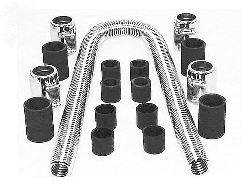

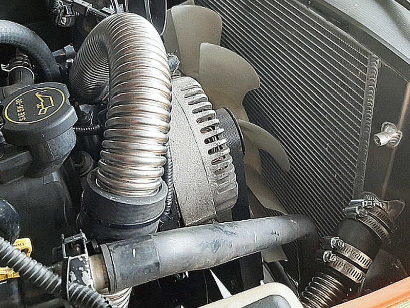

1.5"ID StainlessFlex is a good option for custom Radiator Hoses:
* easy to route+bend+shape+cut
* slightly increases cooling capacity via metal corrugations
I use short sections of 1.5"RubberRadiatorHose+DoubledUpStainlessWormClamps as couplings & heatshields,
instead of the cheesey\cheap Chrome Couplings+Clamps that come with these kits.

StainlessFlexHose kits come with several rubber adaptors; one of them will likely work.
Or considering 1 3/8"ID is not much smaller than 1.5"ID,
wrap the smaller HoseBarb with several rounds of TeflonTape,
before installing the 1.5"ID Hose, then use good quality DoubledUp WormClamps.
