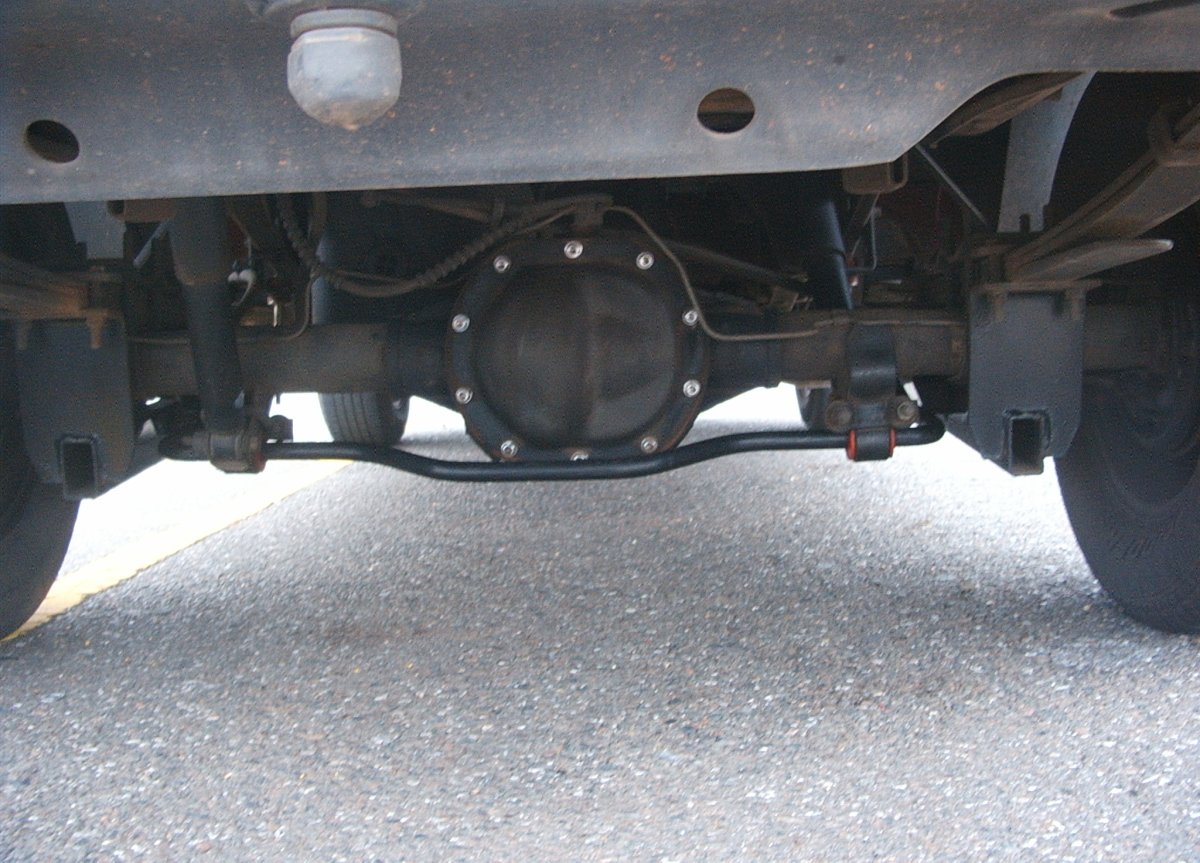

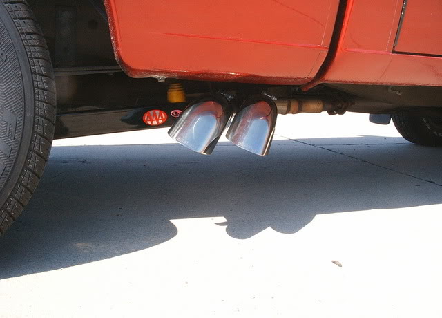

Look closely at the pic I posted on Page 1. You can barely see a black Lakewood traction bar extending forward from the tire. These clamp to the spring also. These are specifically made for the Ranger, oddly enough. They mount perfectly, and place the snubber about one half inch from the lower surface of the spring, right behind the eye, which is ideal. It's not ideal to have the snubber hit the eye. And so, when things start to wrap up, that half inch disappears in a New York City Minute, and no wrap. Mine used to have horrible wheel hop. Not anymore. Those traction bars have been on there since I put the Hellwig anti-sway bars on it in 2002.

Why is it not ideal to hit the spring eye?

In the past, I had heard they should hit the eye. But later in life, I read it's better to have the traction bar hit the spring in an area with a little give. Hitting the lower surface of the spring about an inch behind the eye, has a little give. Not much I'm sure, but maybe just a teensy red "C" hair.
Thanks for your explanation. Right now I don't agree but will do some research.
