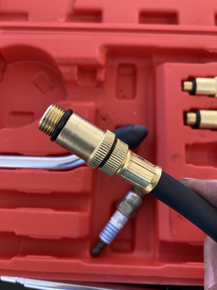

Hi guys, I bought a compression test and tried to use it yesterday but the 14mm adapter would not screw in to the spark plug hole. Do I need a different adapter? Maybe one that is longer/deeper? Is 14mm right? See the one I used in the attached photo. Thanks.

You need the longer version, same 14mm but longer, twice that
I used a "spark plug anti-fouler" to extend mine.
