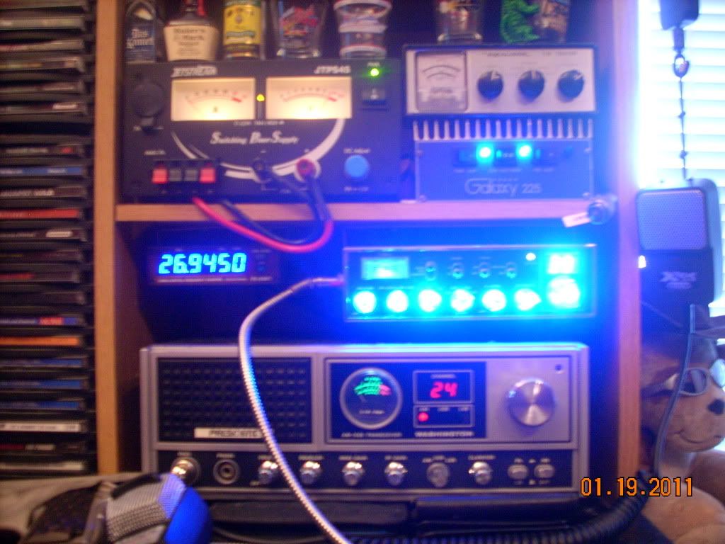

im running 500w base with an A99 30ft in the air, 300w mobile with a wilson 1000 ..... running all export galaxys, other than my SSB president washington. I wanna kick it all up a few notches but want some of my freind to get back on the air before i do it
