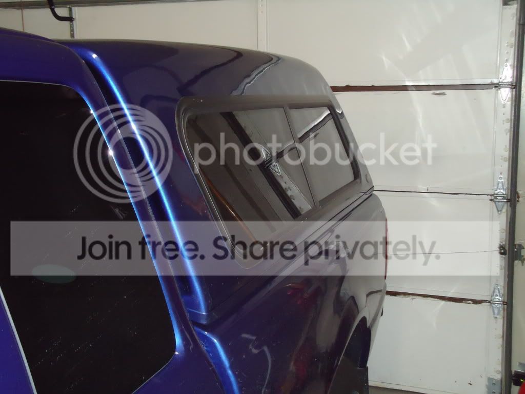

where to put it...
I had thought about a mag mount; actually I still have one that I used with my Mazda B3000 but don't like the idea of the cable running across the top and the chance of it scoring the clear coat/paint.
One thing I had been thinking of was an adapter or bolt-on that would fit where the third brake light is. Since the topper already has its own brake light, I don't really need a functioning one on the truck.
Well if this guy,
where to put it...
Could put a tonneau on over this mount, I don't see why you couldn't do the same with your topper. The mount might need a slight bend put into it, but otherwise...
