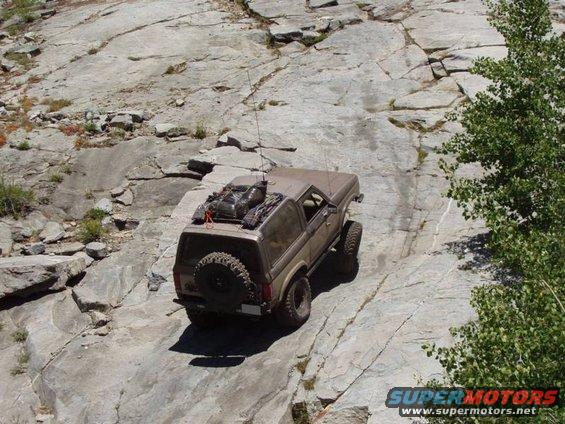

I have a 66" Francis Hot Rod CB-26 on a triple magnet mount on the roof of mine. Excellent range. Only thing that would be better is a 102" whip, however the height of that starts to get a bit too impractical (I have a spring on mine so when it does hit something such as a low branch or drive-thru overhang, it can flex harmlessly out of the way).
Here's a pic (one of the few I have that the mag mount is (sortof) visible in)

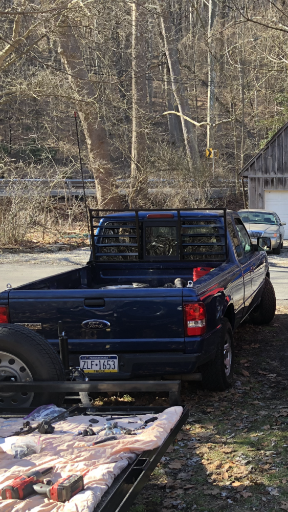

Just an idea, when I built my carrier I threw a tab on it to mount an antenna.
You can barely see it behind the actual spare tire mount. There is another one on the other side for a off road flag.
I know BII carriers are different (that is where I got the bracket that holds the tire) but welding or clamping a tab isn't really rocket science.
