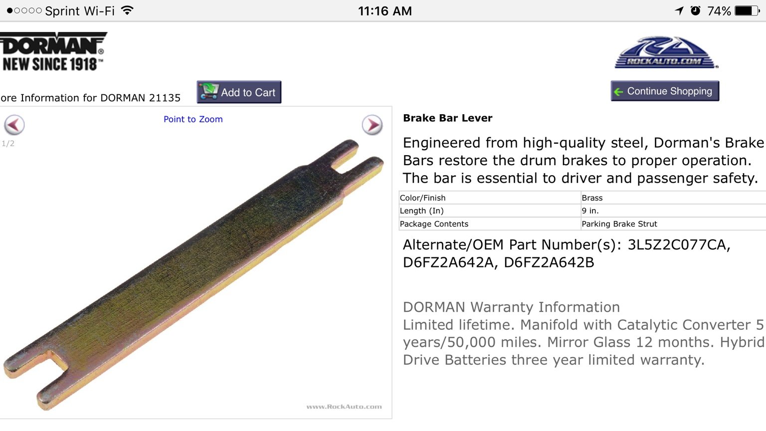

I'm missing my drivers side parking brake strut and was wondering where to find a new one? I've been searching the internet but haven't had any real luck finding the one for 10" drum brakes.

Do the parts lookup for a 1991-1994 Explorer and you'll get the right one.

Sorry Floored you are too smart to be a manufacturer. The 10" bar is very different.
Just would like to say that the 91-94 explore break strut worked like a charm!
