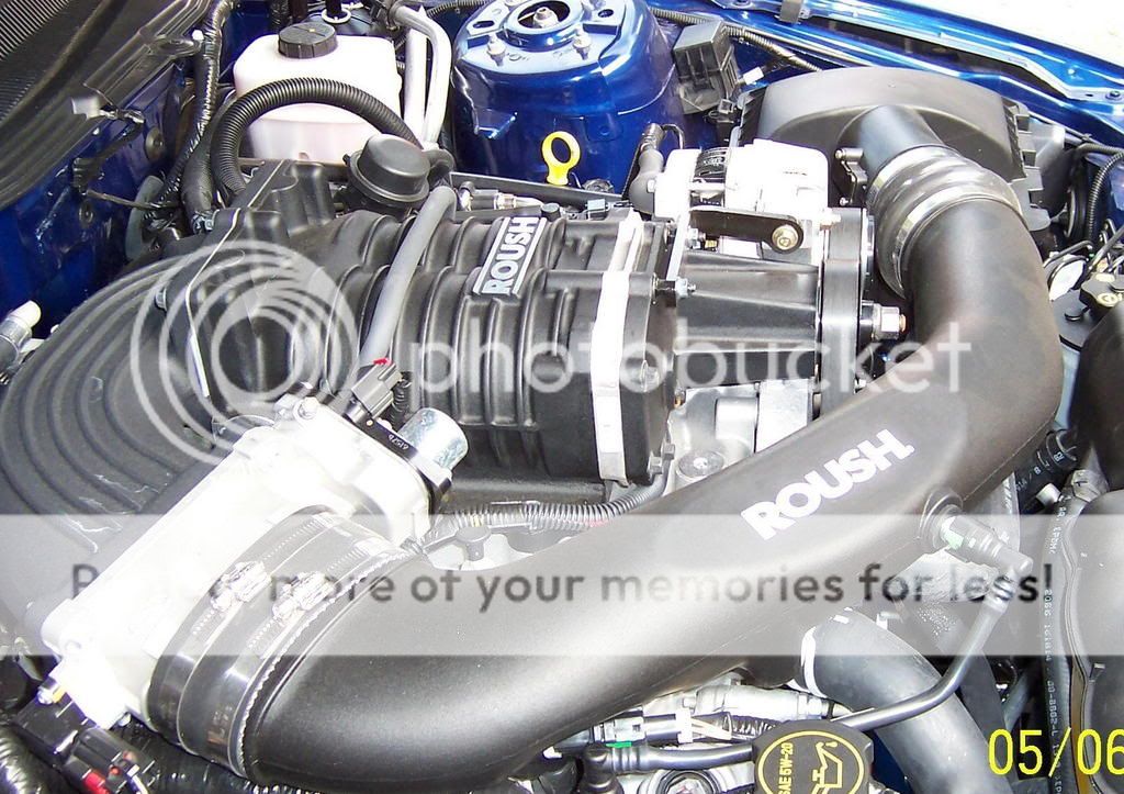

Dave has a Roush 427R?
It's a secret, don't let the beast out!
One hell of a car to drive in good weather! Worked all my life to get one like this, do the same.
Dave
