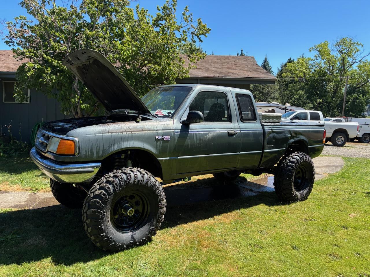

I don't consider mine a serious offroader but I have fun and it works great with the tweaks over the years... one of these years I'll get to building up my Explorer, it'll be more multi terrain capable, still don't plan on it being a rock crawler but it'll do better than the Ranger...

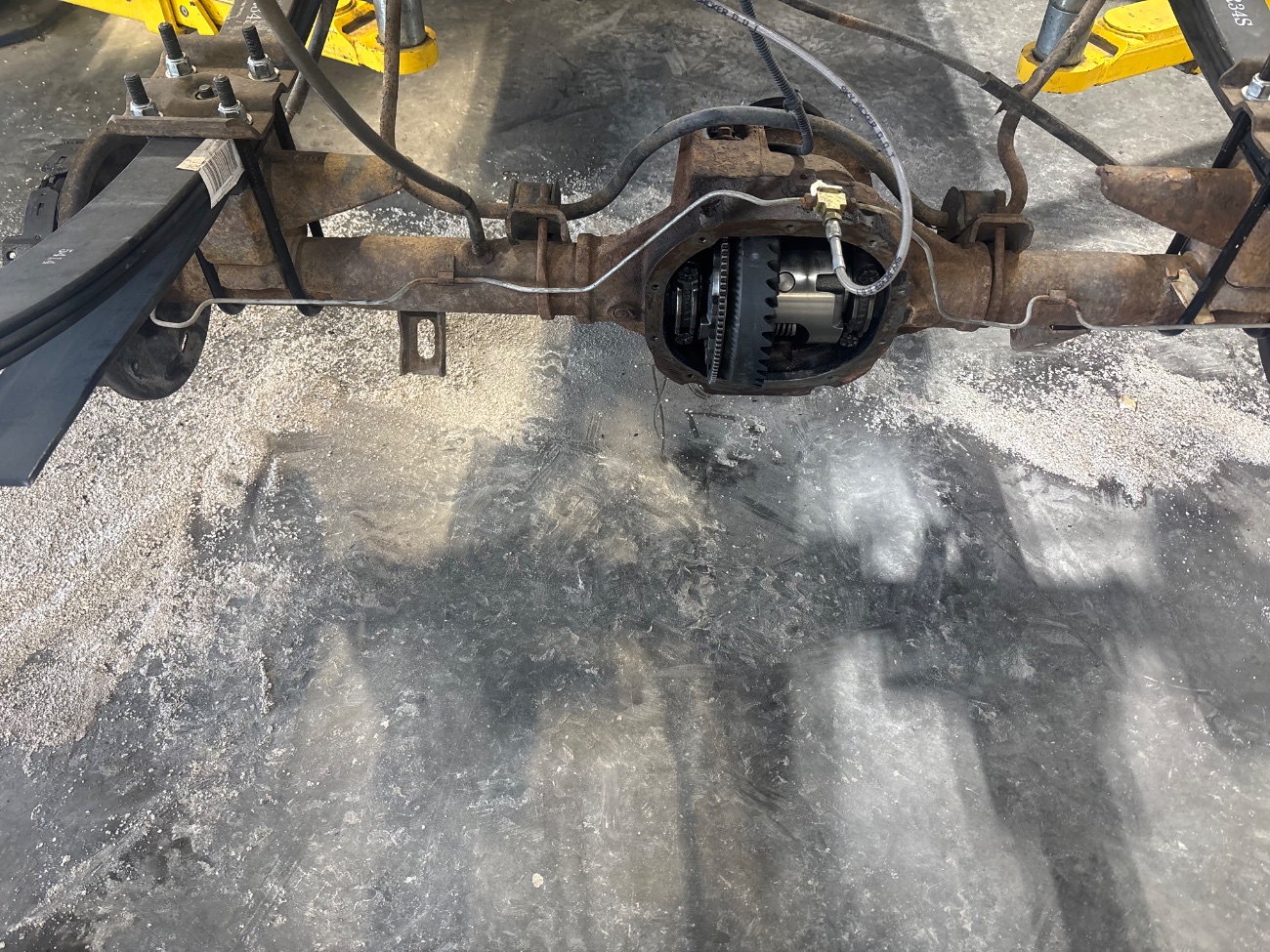

I wouldn't say "serious" but mine is going to be a snow wheeler. still currently has the 2wd trans in. waiting till I find another case to throw my strong box together. Hp 44, 9" rear, chromoly shafts, 5.13 gears, grizzly locker front, spool rear.

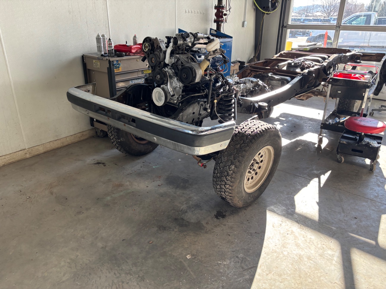

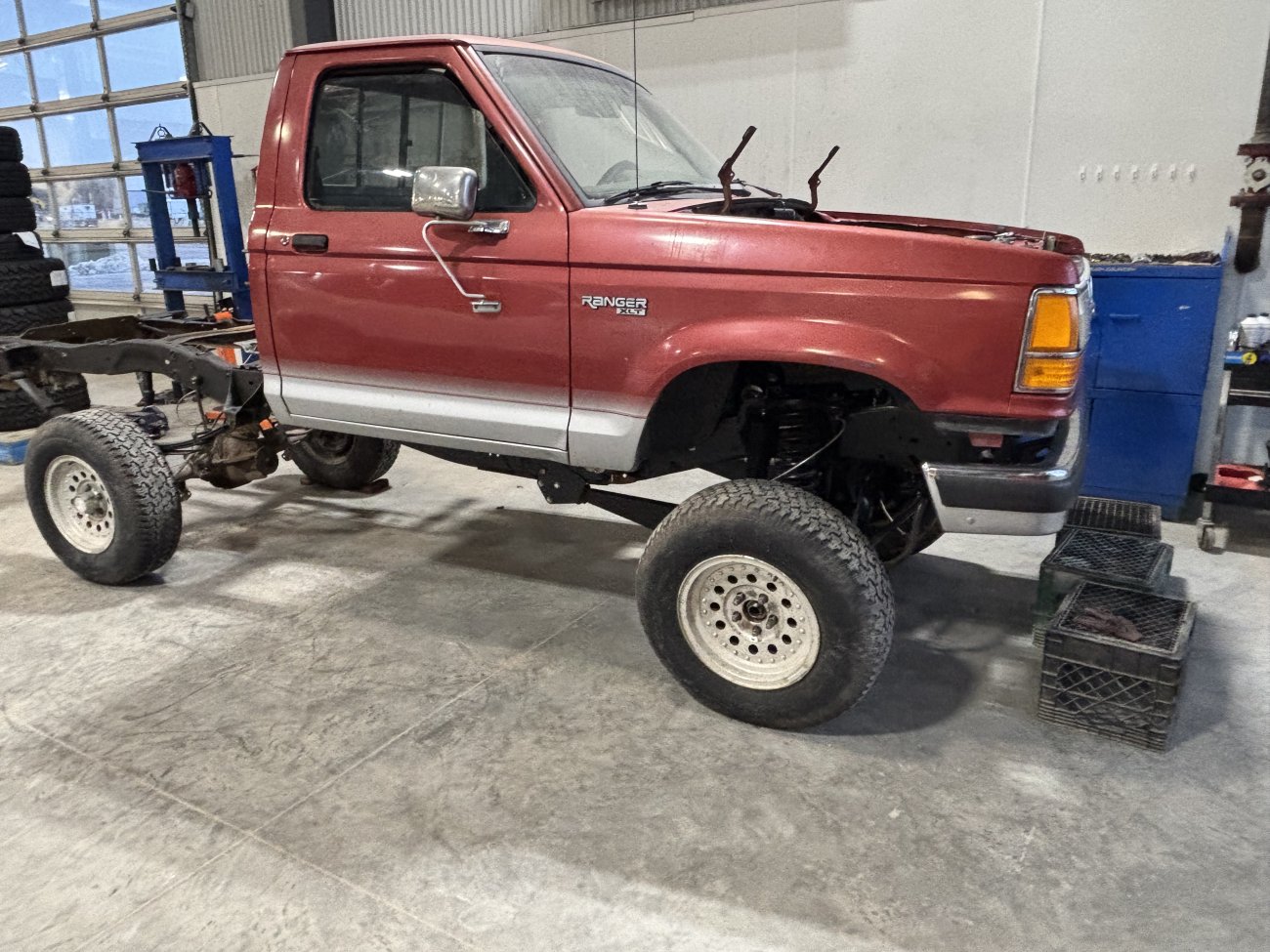

Building a 90 lbsc ranger to specifically go on UA 2027.
This year I helped a rig get into and codriver for the event. It was a blast and I'd love to represent the ranger chassis in a "full tilt" adventure build.
Probably won't be everyone's cup of tea but spec'd as follows: 5.3 carbed turbo,superduty axles, 40s, full hydro, 5.13 +air locker rear, 3 link front, 4 link rear, Air shocks with helper bags on the rear, simple interior with ac. 17-19gal fuel cell. Strategic frame bracing coupled with some Dom rocker rails that tie into a hybrid cage.
This combo has worked for me inside of a Cherokee that morphed into a street legal tube buggy that I would drive daily for about 2 years but never got an accepted application for UA since it was lost in the monotony.
I'm in the early stages of the build where I'm stripping down the frame for the engineering crossmembers and engine mounts, cage tie ins and cut file templates for the bracing.
Wish me luck!
what are you running for a carb and intake?. custom holley double sprung and bridged blown through on a wet floor? or a draw through for atomization and angles?
what ignition?
sounds damn interesting.
what ignition?
Simple single plane. I believe it's a knockoff but the casting is good. I have a 4150 600cfm double pumper I'm building for blow thru.
Using the stock ECU I can tune for ignition only which will allow me to run the fans, show ECT, and OBD2 display still. Also I can utilize the map for kpa readout and interpolate iat and timing adjustment by map.
yup...worth a wide band too.

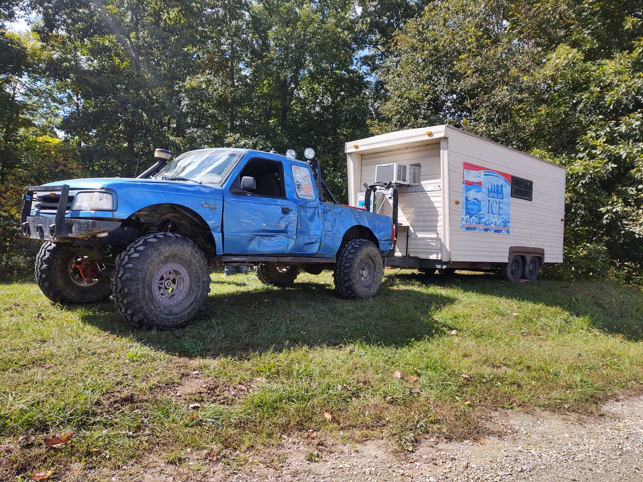

There are a few of us willing to go all in. I will say that I cared more for preserving the original body lines when I started. Most of my brackets are bolted on vs welded to the frame, and I wasnt willing to cut fenders and stuff at first. Basically everything was reversable...until I started really leaning on it and those mental "rules" no longer mattered.
My next scratch build will not follow that same path. lol Tubes will be added and large portions of sheet metal removed from day one.
