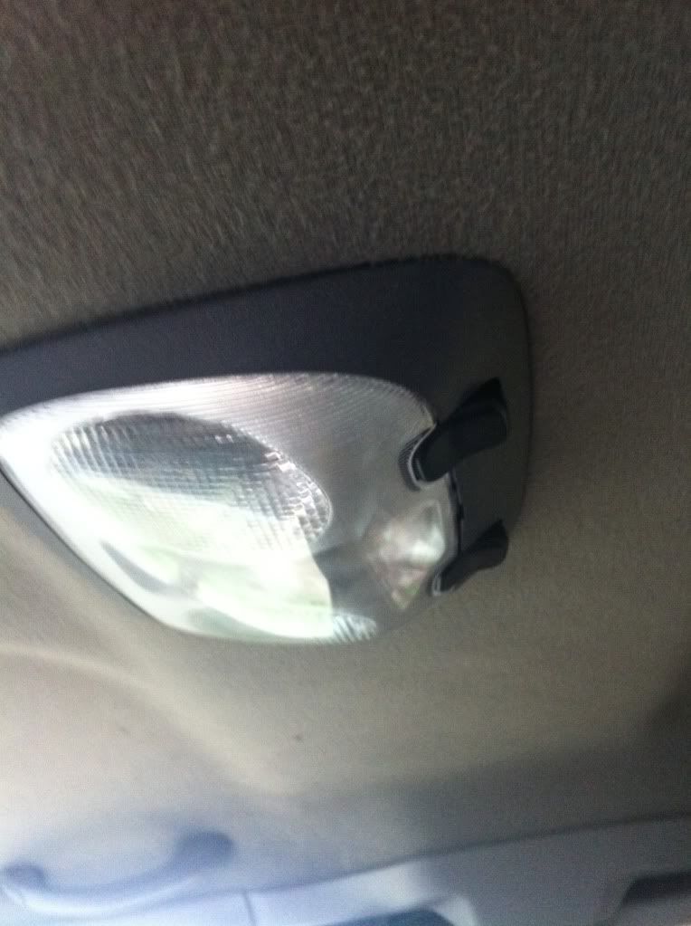

I wonder what problem my trucks last owner had since he removed this.

It was a hole till the explorer dome light you see. I only have it screwed through one connection.
