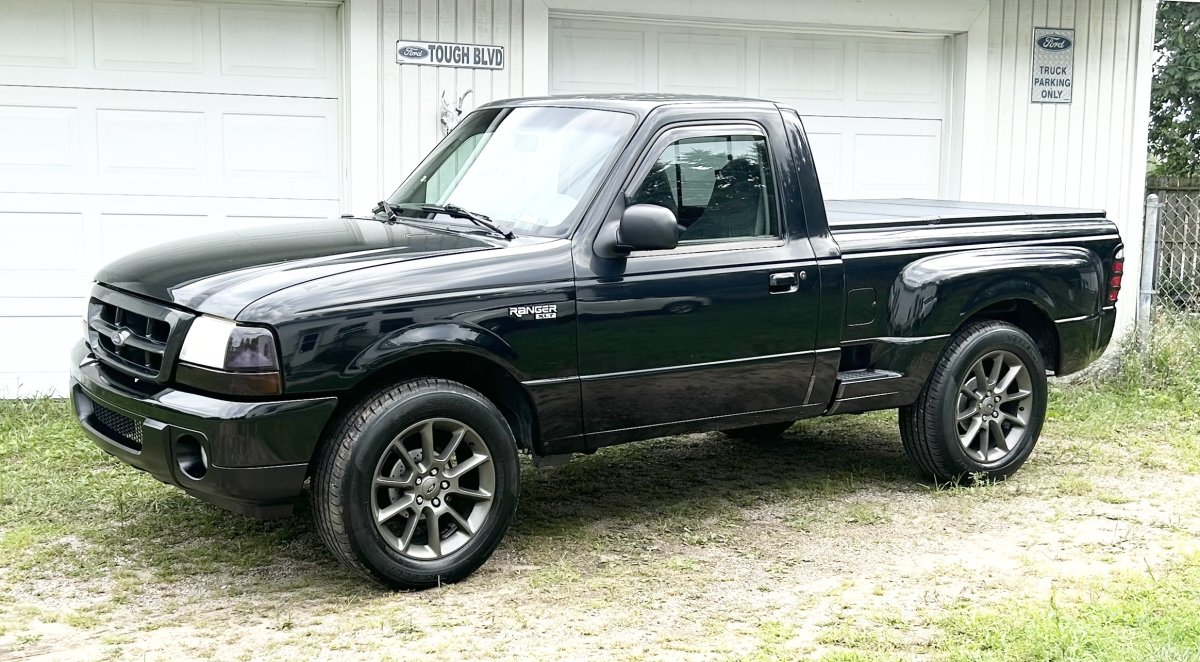

1998 Ranger 4x2 stock suspension, 2010 Mustang 18x8’s with 1” spacers, 245/60R18’s.

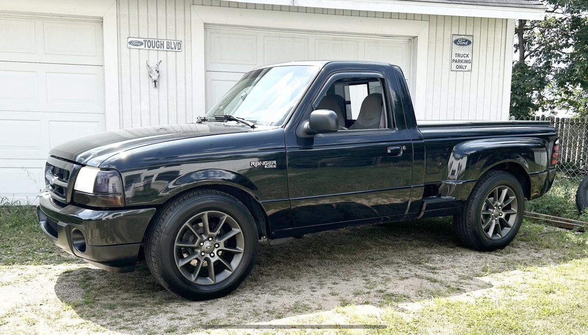

1998 Ranger 4x2, 2003 4x4 spindles & 12” rotors, Moog 80660 (2218 lb) coils cut 2.25” for a 2” drop and rear shackle flip for a 1-5/8” drop. Mustang 18x8’s with 1/2” front spacers (4x4 spindles gave it 1” wider track width) 1” rear spacers, 245/60R18’s.

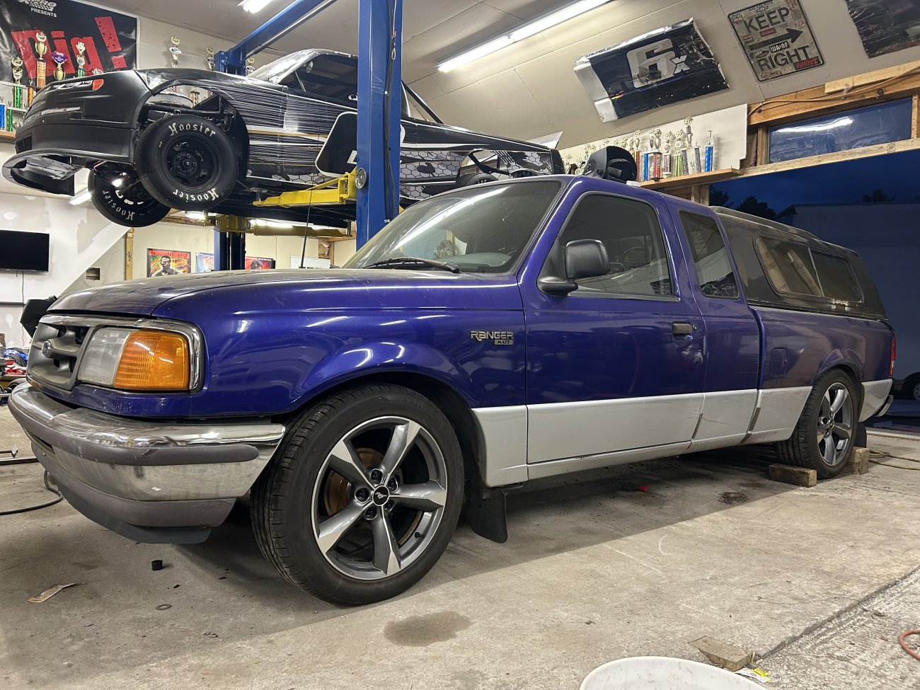

1996 3"f drop spring 5"r DJM axle flip. KYB Nissan hardbody shocks. Mustang 18x8 wheels, not sure what year. 1' spacers all around. 235/50zr18 tires. Front springs still need to settle more.
