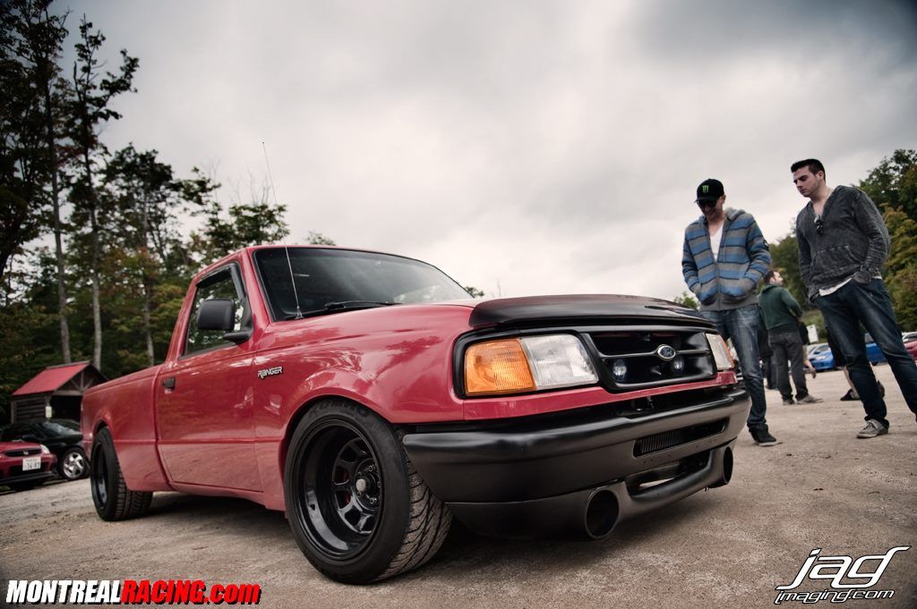

Current ~6.5 inch front with new d-windows 16x10 -38 offset 225-50 tires.. Had to pull fenders 1.5 in. front and pull bed about 2 inches.

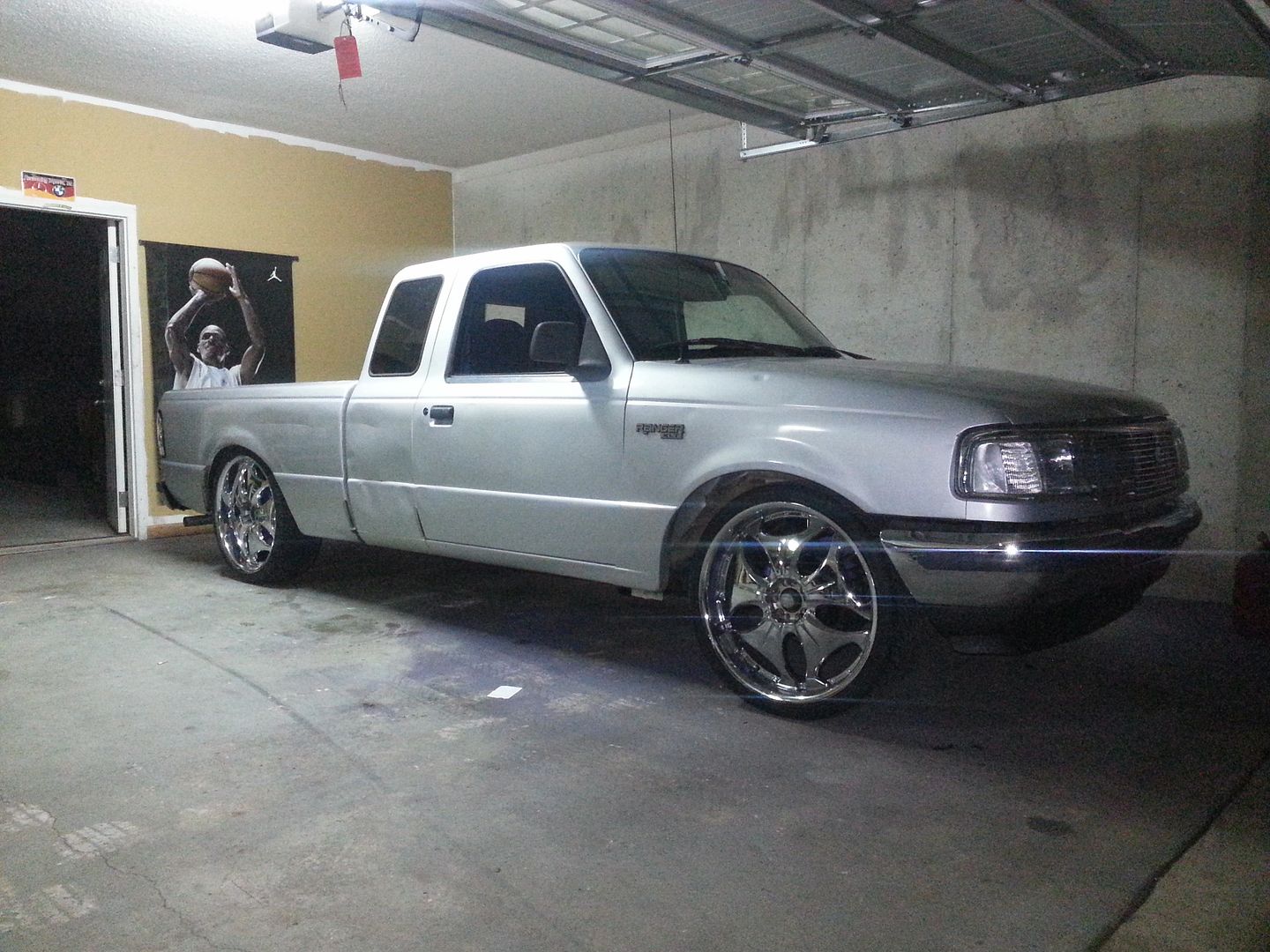

Current Suspension
DJM 2" Spring
5" Flip Kit with 3" shackles(on 2" setting)
Net Drop - 3"/4" from stock (soon to be 5/6 drop)
Front Wheels
20x8.5 Zenetti Wheels
245/35/20 Hankook Ventus V12 Evo's
Rear Wheels
20x10 Zenetti Wheels
275/40/20 Hankook Ventus V12 Evo's

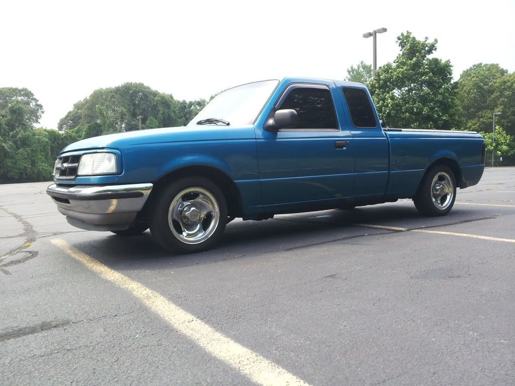

2" DJM springs & flip kit on the inner shackle holes, sits at about a 3/4 drop
235/75/15

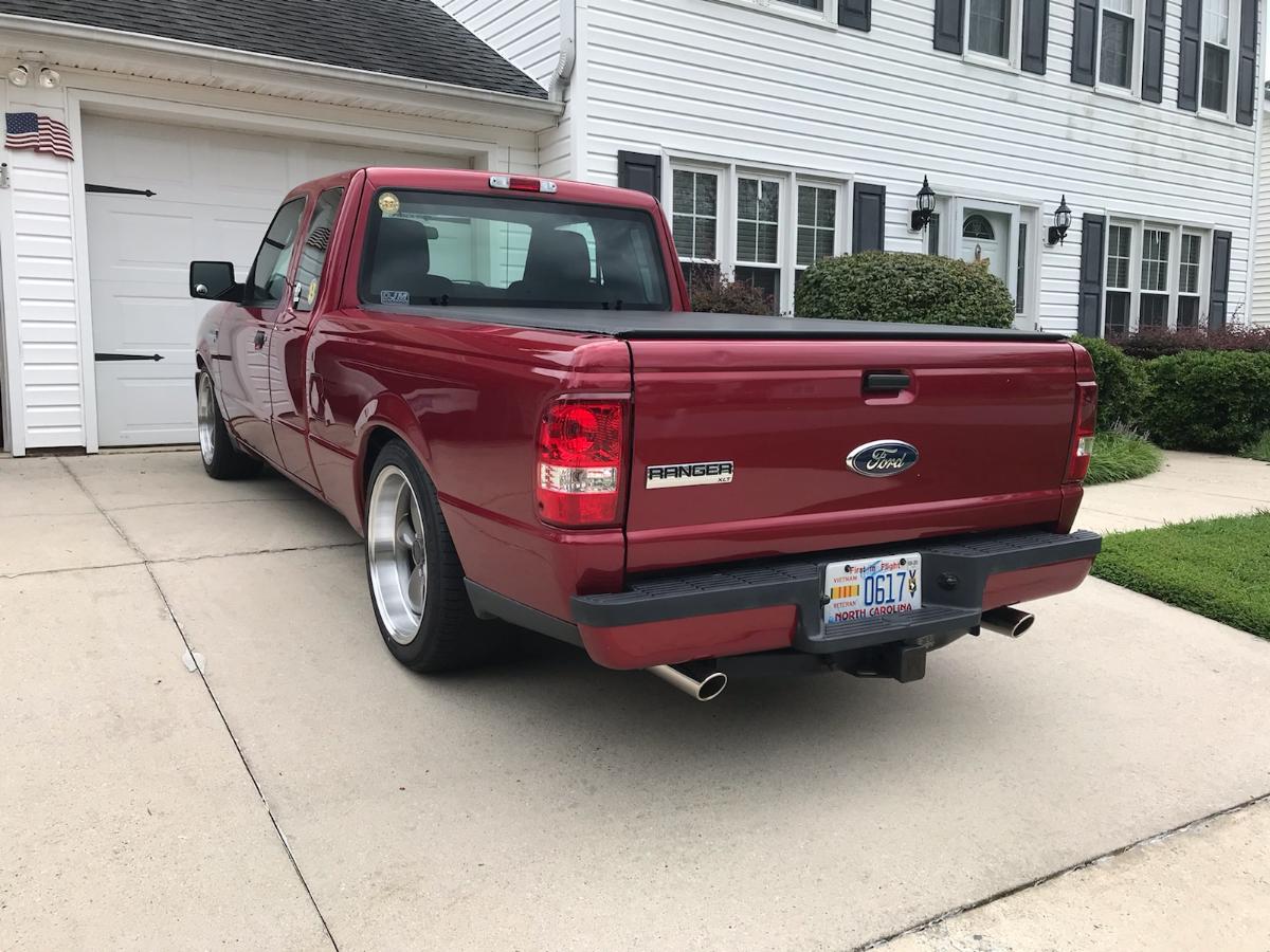

Nice to see another Ranger with pipes in front of the axle. Mine have been like that since forever. However, it causes problems with my polished rims, I have to polish the right rear rim much more frequently than the others. Also the chrome lug nuts get heavily discolored and need replacing more frequently that the other three wheels (the current ones have a goldish hue on the right rear only). I guess my Lightning doesn't suffer in this regard since the rims are powder coated instead of polished.

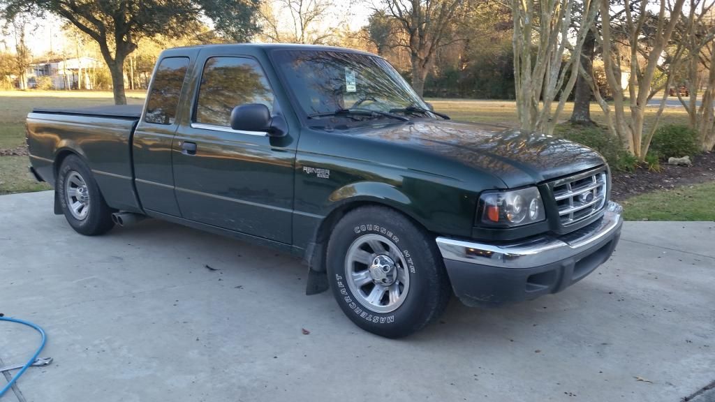

2001 Ranger
Stock height for now... plan on either just axle flip or explorer axle for rear, then the full DJM kit for the front.
Wheels 16x8 94-04 (I think) Mustang...no spacers or adapters needed, even hub centric. With 225-60/16 tires. Cant wait to get low...

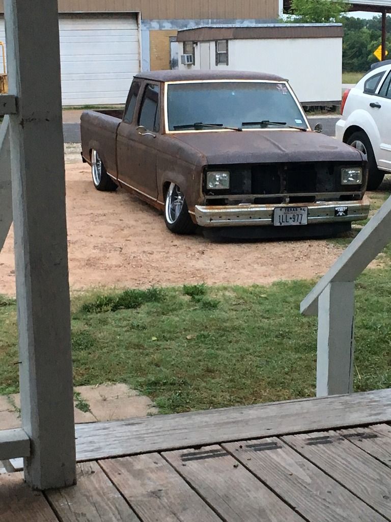

Bagged on boss 338's, staggered. 18x7 front and 18's in rear. Had to cut the rear fender lips to male it work but thats fine

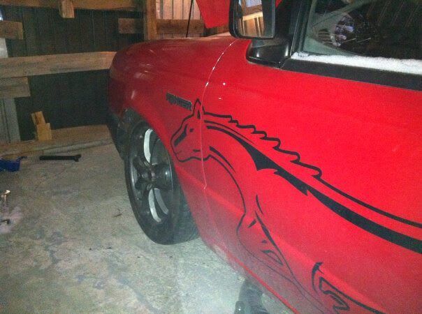

DJM 4/5 kit. Front rubs very slightly, put 7/8 spring rubber on both sides, race car style, wraps a full coil. Doesn't raise the car, just limits the amount it can drop. Now only rubs on big dips and bumps. Flat of tire hits top of fender liner. 245/45-18 - 275/40-18. Rears are fine no issues.
Bullet 9 x 18 - 10 x 18

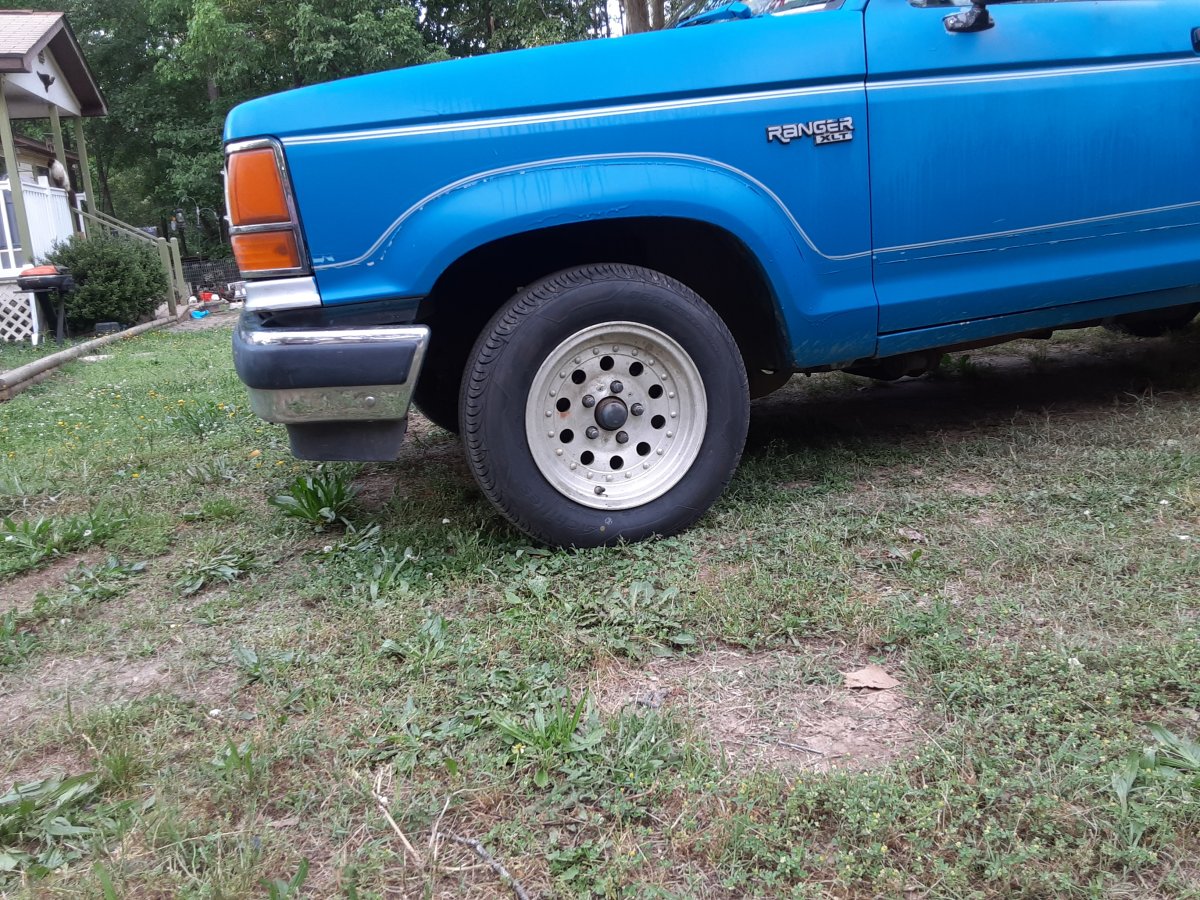

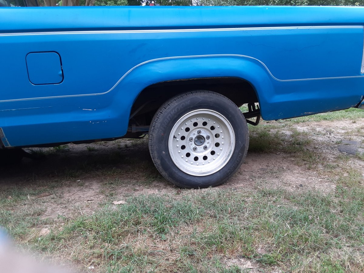

14×5 10 holes on front 15×6 12 holes on rear, the other 14' came on the blue truck when i bought it but there on daddy ranger now!
