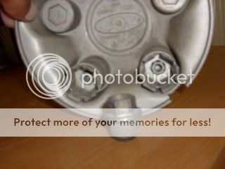

This is the lug that fits the cap, notice how the nut has a ring around it that holds the cap on. I just got new wheels and had them laying around. good luck.
