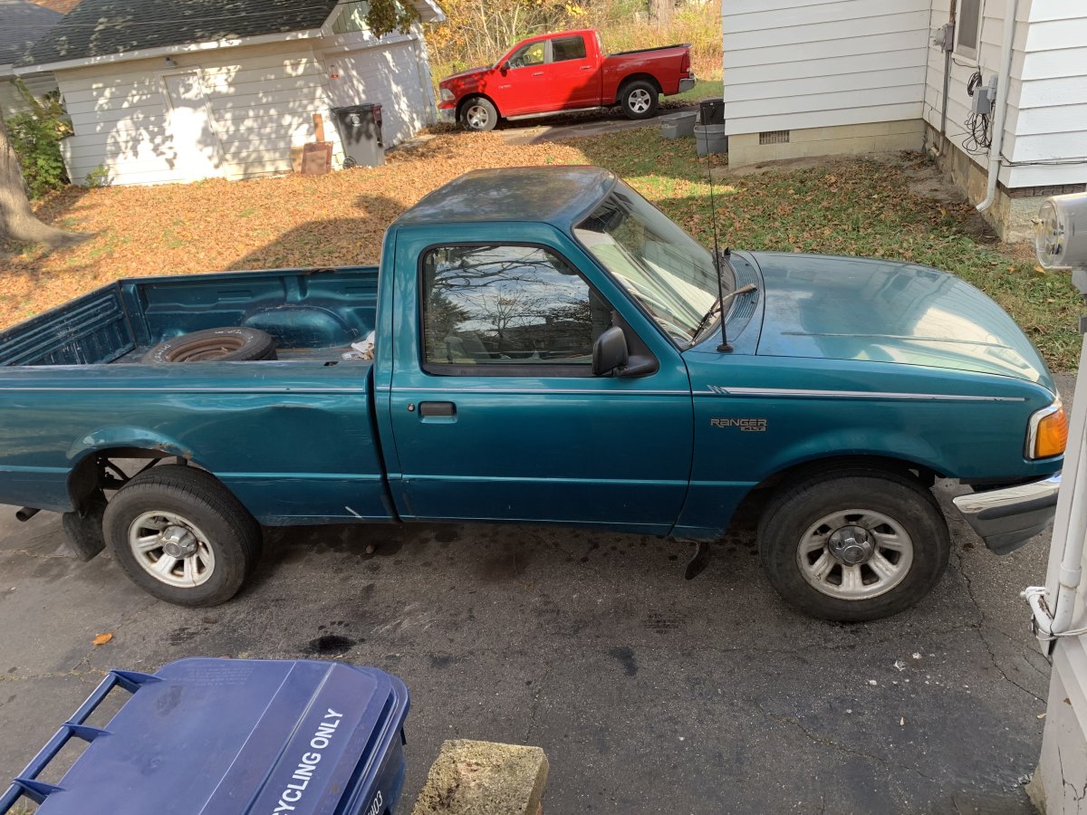

Yeah I guess I just found one that looked most helpful but good to know. They are on now. The center hole was just making me overthink and the lug nuts just had to work down a little further on the new wheels. I just backed them off cleaned the stud and tightened again. Good to go now. Thanks for the replies!
